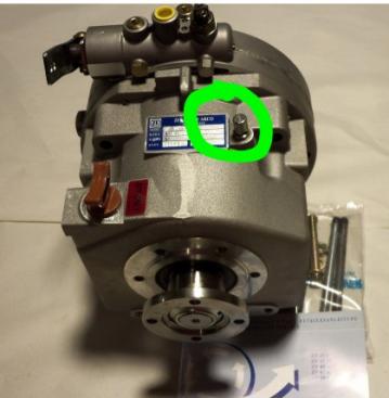

    At 250hrs you either have a failed seal or a clogged vent.
    There is a vent with a steel cap that allows pressure to escape all the time. The rotating oil will pressurize and gets worse as speed and load increase. If the vent is plugged it will force oil out and damage a seal or the oil burped out of the vent.
    I would check fluid levels while floating level (no ballast). If low add fluid and have someone drive as you look for drips. Be careful as the shaft will be spinning and exposed. Most likely the leak is where the Trans meets the engine.

    Thanks for that, where is the vent located or is it obvious?

    Kinda obvious but it's painted the same color black as the case.

    Holdmybeer you were right on the money oil ATF coming out of the vent, changed the ATF and now good to go, was also a small leak in the oil filter when I had the oil changed I believe the filter got tightened a little to much and pushed the oil ring on the filter out of place.
