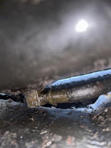

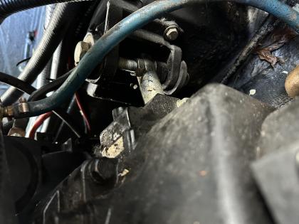

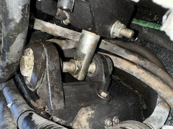

    The 2009 had bad motor mounts that will chew up the rubber bushings. You need to change your rubber bushings $8 when I did them in 2011 or so and grind your mount so the flange does not have a lip on it. You will see/ feel when you take the bushing out. If you don’t round it off it will happen within a year. I couldn’t be bothered to take it to dealer even though it was under warranty back then. It’s about a hour job. You need to check your alignment after, as I can tell you it is definitely out right now. Look for my motor mount thread
    hear is a brief video showing the mount flange lip that needs grinding
    https://www.youtube.com/watch?v=N8eXLXnFcX8
