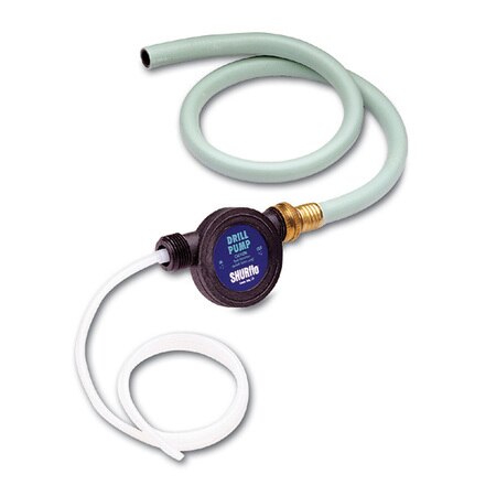

Since then, I run the engine for a minute to get the oil warm, run the factory drain hose out the back of the boat, hook up a small pump to my drill and attach the hose from the drill pump to the factory hose. Turn on the drill and the oil gets suction out in a minute or two. Very easy.
