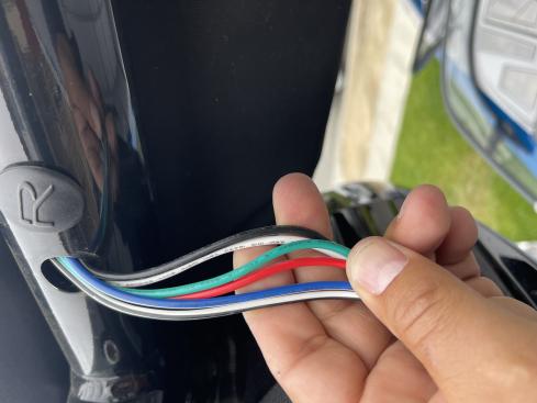

    Hello,
    So I’ve taken the Black piece off under the dash and found the rgb power connection to hook a module up to it. But I still can’t find the led wires to plug into it? Any idea where they could be? Any help would be greatly appreciated

    The plug under the dash is 2 pin, and wired to the RGB switch. The LED strips in the boat are RGB strips but the wire that runs around the boat is only 2 wire if you do not have the RGB option.
    You would need to either order the OEM ITC Versicolor controller or a cheap controller of your own, the 2 pin (+) and (-) connection under the dash would provide power to a RGB controller.. then you would run the RGB wire to the controller.

    I have RGB wires running to all speakers and in my tower. Just can’t find where they start so I can connect. IMG_2063.jpg
