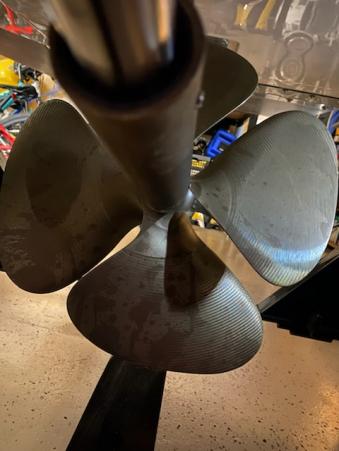

My sister in law hit something with our boat. There was no apparent damage but it vibrated at 8 mph. Changed the prop and the vibration went away. Took it to the prop repair shop and there was a slight bend on one of the blades, causing the prop to be out of balance. You have three blades different from the fourth. That could be enough.
