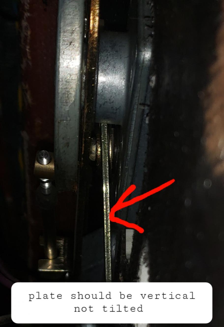

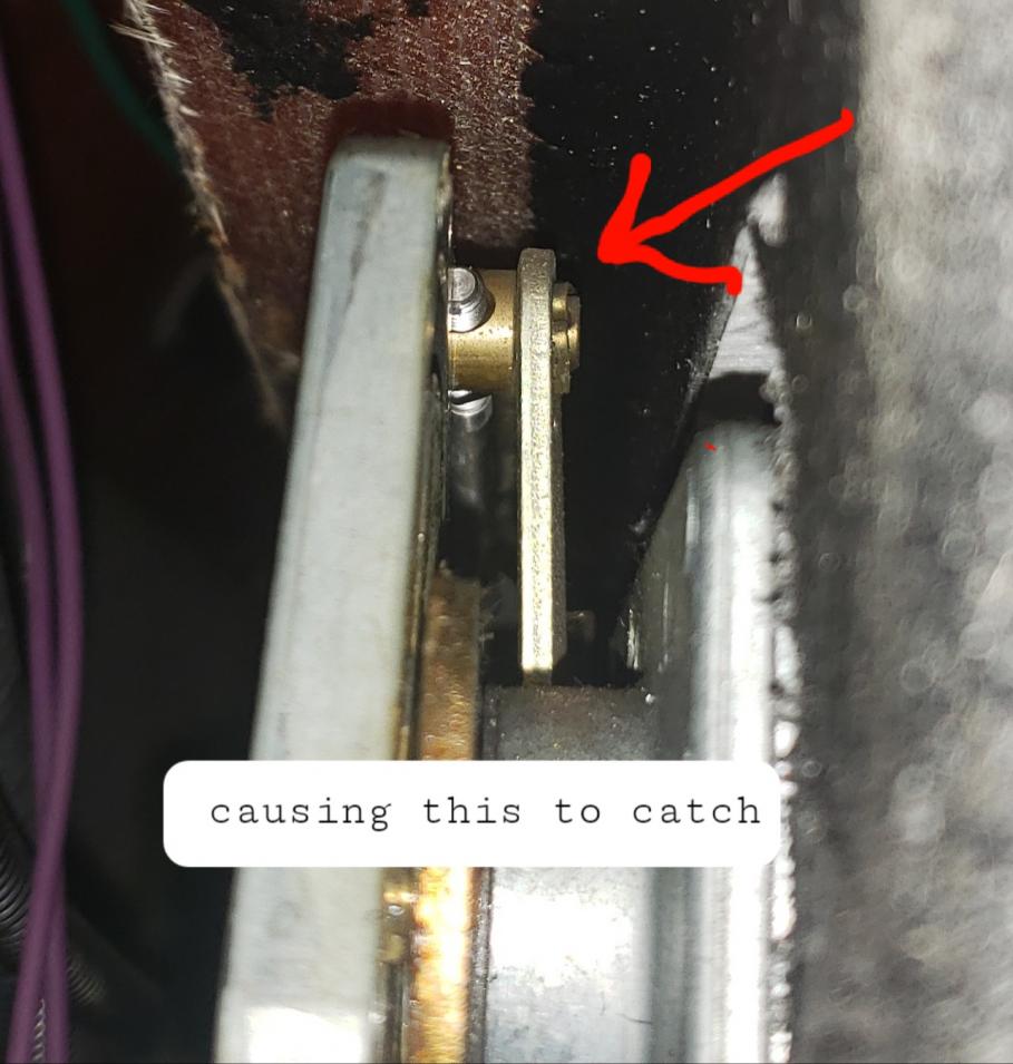

Any way you can reach the screw head with a good pair of needlenose pliers to turn it. Not ideal and may have to turn it in small increments, but it looks pretty short.
