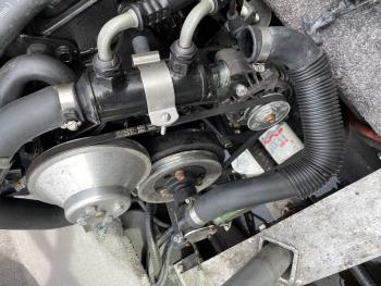

    Need to make sure I get all of the water out prior to it getting cold here in Colorado. I Have a 2008 Moomba Mobius direct drive. I removed the drain plugs on both sides of the engine. There is no strainer for the raw water coming in (not sure why there’s not one). I disconnected the crossover T where it goes to the drive shaft. So how do I get the water out of the transmission? The transmission transfer is up high on the front of my engine. 1369F111-337D-494E-A120-53A5AA6C412A.jpg1369F111-337D-494E-A120-53A5AA6C412A.jpg

    I think I figured out the transmission. No water actually goes to the transmission, only ATF fluid. The water stays in the transmission cooler that is pictured in my previous post. Is this correct?

    I think the confusion is coming from you have 2008 with a GM block. The original post was about a Raptor motor with blue drain plugs for the trans cooler that has raw water - which your 2008 boat would have it different part. On the GM trans cooler there was a lower hose to disconnect to get the water out - I think there was a brass plug on the bottom too, but removing the hose got the water out and was easier to reconnect in the spring. Plus, if you do not have a strainer, you may have lake debris in that too.
