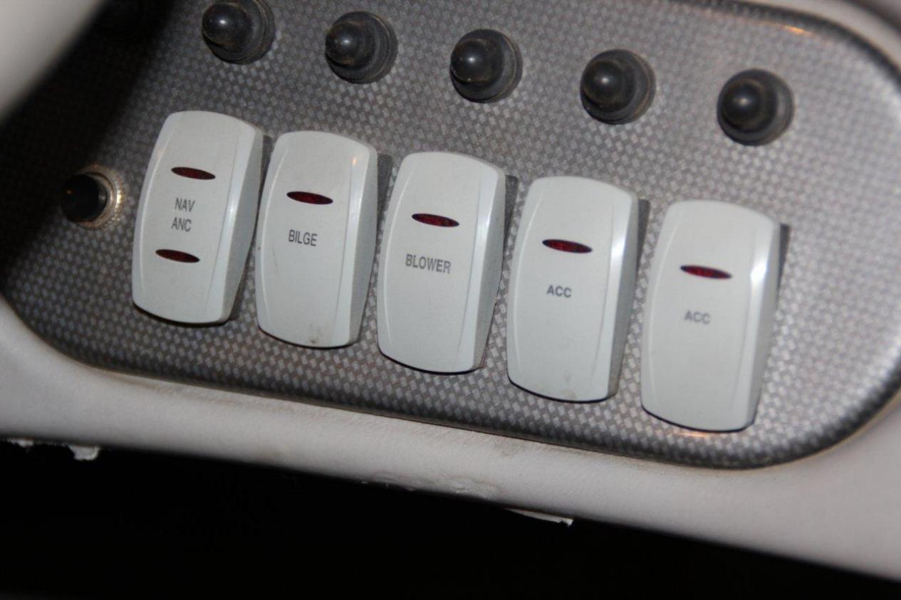

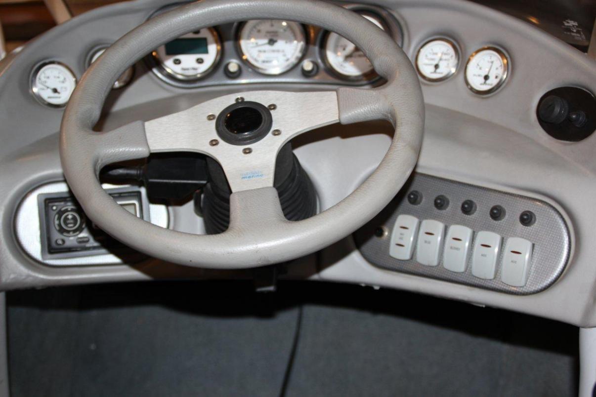

    So I am redoing the interior and getting new dash switch covers from the guys at OTRATTW (took me a while to figure out THAT name)

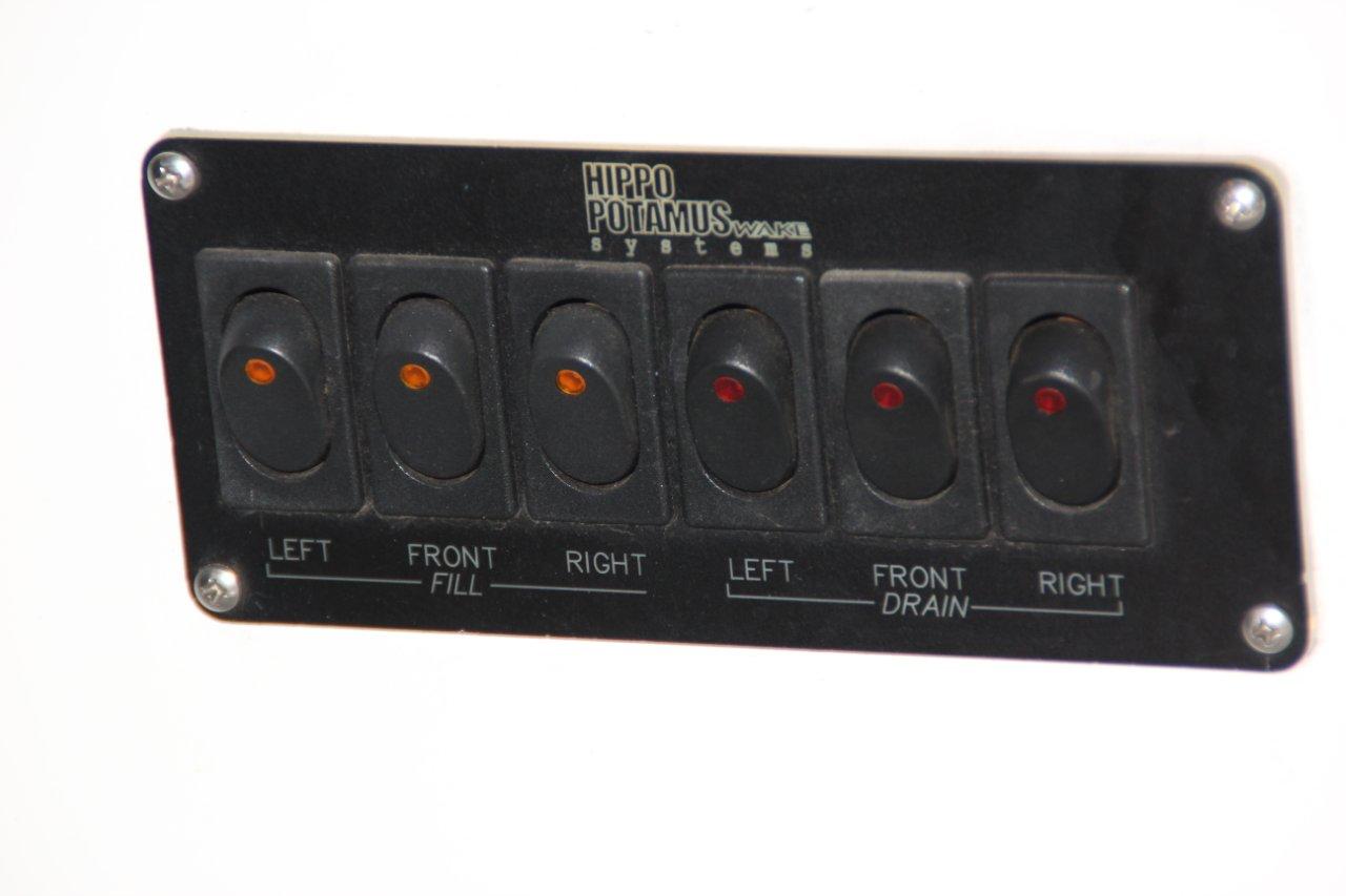

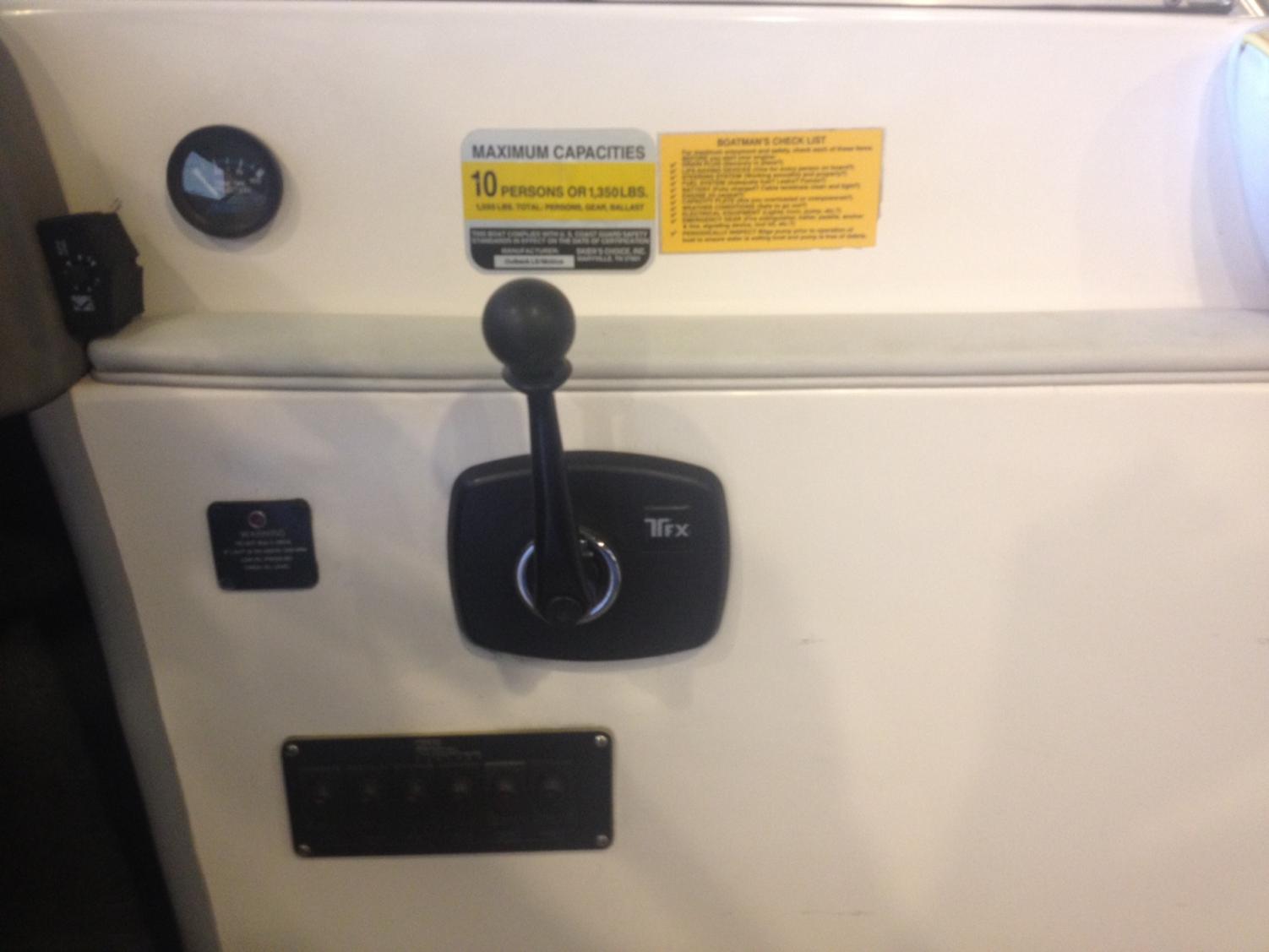

    So I figured that I would also take the time to replace and relocate the rediculous stock placement of the Hippo Ballast Switches up higher were we can
    1. See them
    2. Get to them
    3. Hopefully not leave them on
    4. NOT Fill/Dump the wrong ones
    • Can I replace the existing 6 switches with 3 switches?
    • And would they be DPDTs? (Double Pole Double Throw)
    Thanks, Eric.

    I don't see any reason why you could not replace the 6 with three. You would have three switches that when you flip them upward, fill...downward, drain.
    I believe these are DPST (double pole single throw) switches. But I would ask the folks at otrattw to verify.

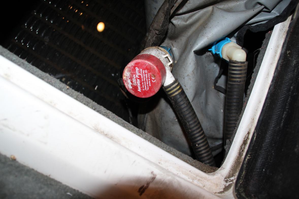

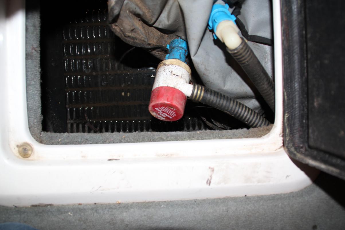

    2002 right? $10 says you have aerator pumps.
    Switching over your wiring to new switches should be piece of cake (still). Which means running all new wiring to the pumps is really not necessary if they are all working at the moment. Unless you're looking for ways to tear the skin off your knuckles during the winter months.

    If you are using three reversabale pumps, you need three DPDT switches. You will need to bring a (-) lead to the center left and a (+) lead to the center right of each switch. Wakemakers has a wiring diagram for this.
    http://media.wakemakers.com/2012/08/...pump-switches/
    If you are using six aerator pumps (three fill and three empty), you can use three DPDT switches or three SPDT switches. You only need to bring the (+) lead to the center of the switch. The grounds (-) for all the pumps can go directly to the ground block. And note that you only need to use one side of the DPDT switch in this case.
