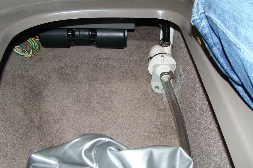

So I've completed my ballast with some of the ideas I've talked about on other threads. First I've upgraded by adding an additional Rule Fill Pump.
Next I added a new header from Home Depot so all the solenoids are out of the way and I have a new feed for my second pump.
And lastly I've used one of the unused drain ports on the front ballast bag and made a new overflow that feeds my integrated bow sack (ok not really ibs, but it will work for now).
And installed a new separate discharge pump that will eventually feed out right next to the factory floor ballast discharge.
I have yet to water test yet so we will see what happens. Worst case I'll have to upgrade to a 1" thru-hull for water supply. But at 10 gallons a minute each pumps should feed fine through 3/4 since 30gpm is reccomended max flow through 3/4 pipe, plus its shuch a short shared route I don't think I'll have problems.
Newty

Nice. Let's see if I understand correctly:
- you have replaced the solid intake pipe with a solid T junction of the same diameter, feeding to two pumps.
- These two pumps feed (using some larger-diameter hoses) into a two-to-three header, which go to the three sprinkler valves as usual.
- The original hoses from the solenoid-controlled valves to the sacs remain as original.
- Your center sac's unused port now fills the new bow sac, fed from the port side.
- The new bow sac will drain on the starboard side into... will it rejoin the existing plumbing, or just go into the bilge?
Did you do any rework of the sprinklers after the header? I think that there was some talk of changing the valves for larger ones, or removing springs, or some such.
Thanks in advance!

It looks like a reducer but it is all one piece. Just unplug the pump and pull the hose off. Then spin the valve and 90 off the thru-hull. The fitting is set up so if you need a 1 inch thru-hull, you can cut the 3/4" portion off and thread on a 1" fitting. The inner diameter of the thru-hull is 3/4. Make sense?
