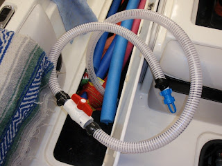

You're right about the power though. They draw A LOT OF POWER! Like 13a each and require 25a fuses. I run my boat while filling/draining as I haven't installed the second battery yet. But for the 8 minutes it takes to fill all 4 bags it really isn't an issue for me. Oh, actually a bit longer if I have to fill the additinal 750 in the seating area which I do after the bow sac is full. I have put in a T-fitting in the line and a couple of shut off valves with an extra line for filling/draining that bag.
Got the idea from a Blog on a Centurion Avalanche Ballast Install. Kinda looks like this:
But I have this on the end of my hose:
Works Awesome!
