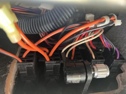

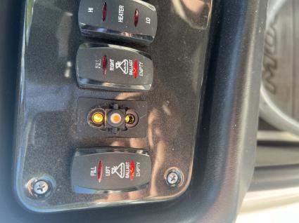

    I have a 2014 Mojo 2.5 and this year I noticed my centre bag only seems to fill. Randomly it will empty when starting and stopping the flow some times. Both lights come on regardless whether selecting fill or empty. May have been replaced by dealer over winter since I was missing switch cover for it and was replaced when I got boat back. Any idea what to check to fix it? How do you pop whole thing out to see if wiring has come loose? What’s the right schematics for wiring for it? Thanks for any advice !

    On my previous Supra, I was able to unscrew the entire panel to get access to the switches and boxes. They should just snap in and out of the housing. There is also a method to snap the wires off the back of the switch.
    At one time I had a switch go bad. It was easy to find out b/c I switched a 'good' switch for the 'questionable' one. When the circuit worked, I knew the switch went bad, thus I replaced it. At the time, I think I purchased from Wakemakers, but there are many marine dealers online that sell switches and rocker switch covers.
