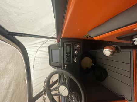

If you don't want to do any cutting, I would get some small "L" brackets and mount it tightly up against the bottom of the helm over your Knee space just to the right of the steering wheel.
this!
it's where we mounted 420's in our supra, our first tige and last tige. we bolted L brackets under the dash to some structural metal for the dash and used small stereo backstrap pieces to "drop" the 420 to hang even with the bottom of the dash.
