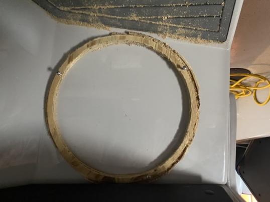

    First, I used my router to cut a template of the surround. I then marked on it where the screws go and mounted my surround template

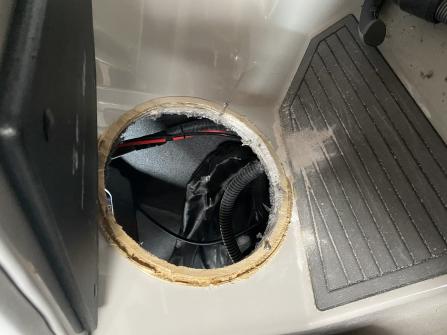

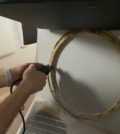

    While there has to be a better way, all I could think of was a Dremmel with a carbide tip attachment. I used this due to limited clearance for a router or jig saw. Took a bit as the Dremmel got hot and I’d have to let it cool.
    Turned out pretty good for the hole:

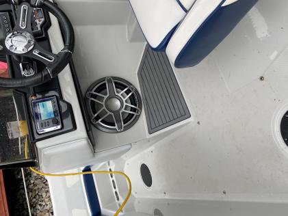

    Default Done
    And the final product:
    It is pretty loud, but lots of dash rattles. I’m going to mat it and have closed off some of the holes on the back of the dash with some success. I’ll get to looking with what people here did to solve that issue.
