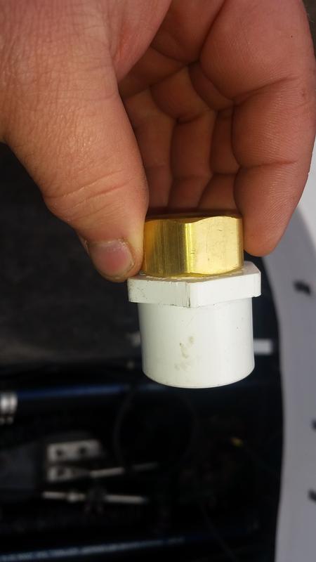

    You can go to home depot and buy some hose and make an adapter to connect it to the garden hose. Just remove the intake line and stick your hose on. There are no issues with using a flush kit.
    This was like 20$, don't think pics are working anymore.
    https://photos.app.goo.gl/7KqEKuHRbyYnfG5u7

    My 98 Mobius DD is super easy to get to the 1" fresh water line. I went to Ace and got a 1" PVC threaded adapter and a brass garden hose adapter. Put them together, remove 2 hose clamps and hook up the garden hose. Easy Peasy and cost around $5. I just drain everything in the fall (no antifreeze). I don't have any ballast bags hooked up (yet).
