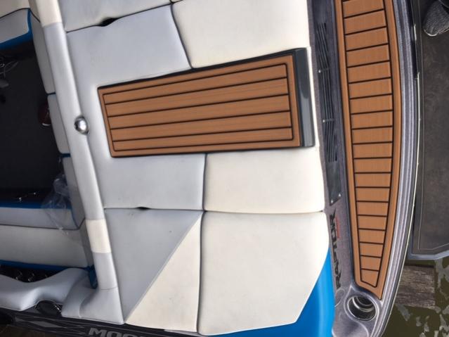

    Back in November I purchased new Gatorstep for my mojo recently with weather getting nicer I have started working on it. Here’s some progress pics.

    You won't be disappointed. Gator step is WAY better than that hard dark crap that came on it.

    Thats awesome! About to do the same thing on mine but I don't have all of the pieces yet. I ordered the walkthough just to make sure I liked the color and pattern so the rest is on its way. How hard was the original adhesive to get off?

    Side note, sorry for the crappy picture. Not sure why they come out so blurry and rotated when I post.
    I found that using a heat gun worked the best. Heat the old stuff pull it off and then heat the glue scrap it off, and then any other residue use a adhesive remover to really get it all up. The swim deck was the hardest part and took the longest
    He ain't lying....the swim deck was a PITA
