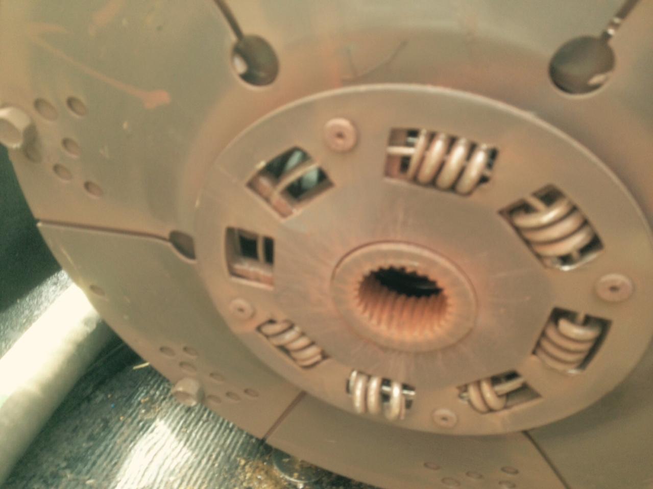

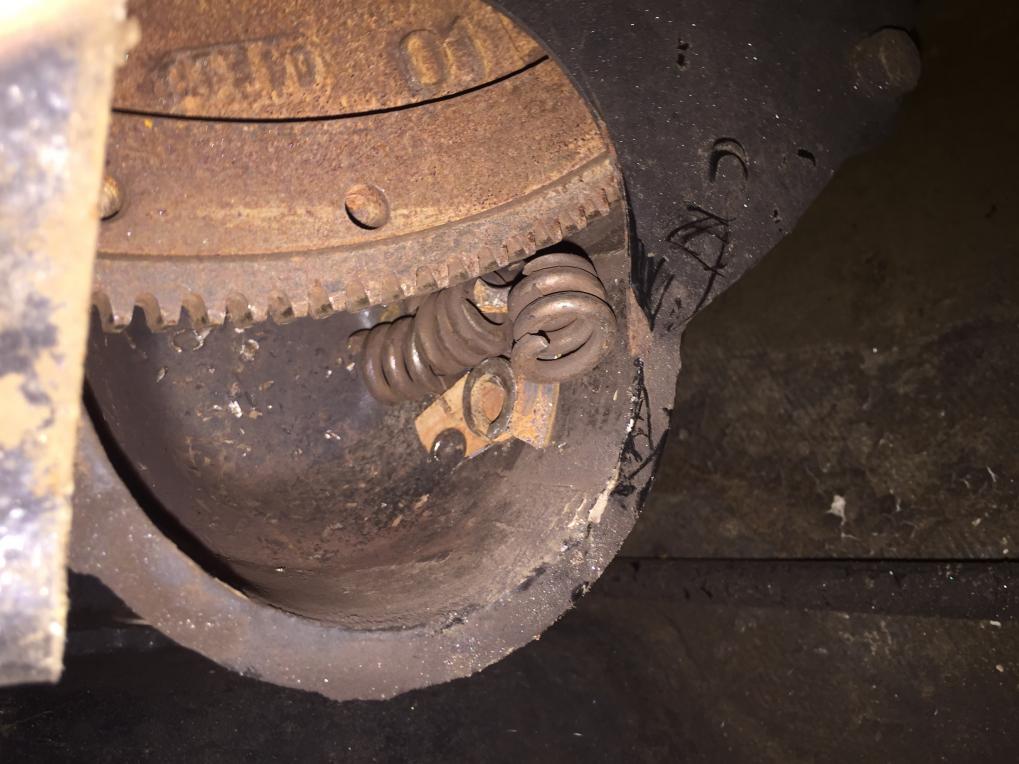

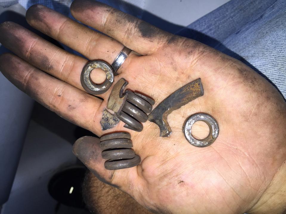

Wow...looks like the 05 damper plates were not quite up to snuff. The aftermarket part looks to be quite a bit more robust, this is the correct one for your engine/transmission http://www.skidim.com/DAMPER-DRIVE-P...uctinfo/97596/ (item 1516). Shouldn't need anything besides the plate, new transmission fluid and some grease for the splined transmission shaft/new springs. Good luck, let me know how it goes.
