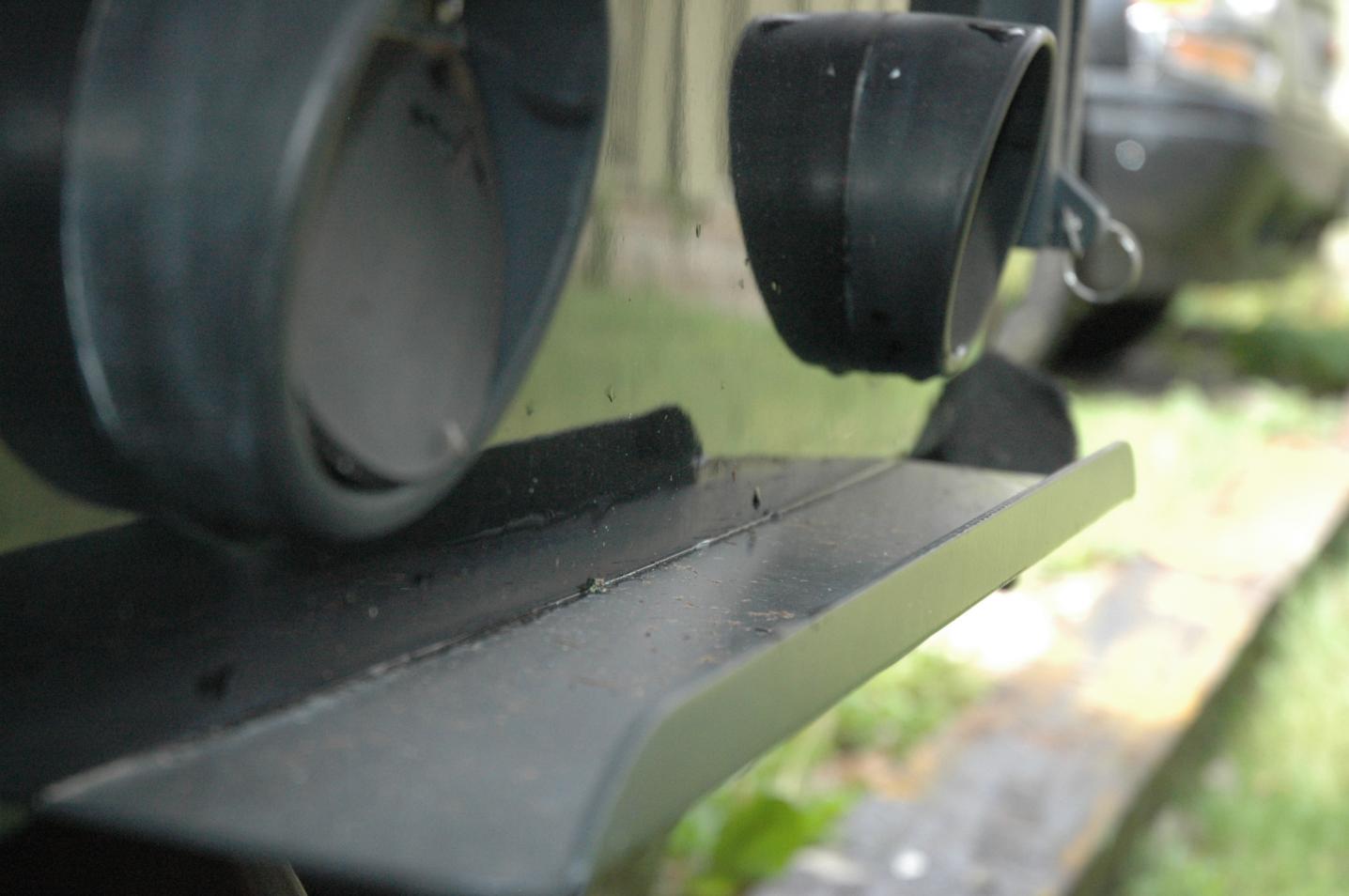

    Is the any advise on messing with the fixed plate?

    Jay Dub - I figure engineers who designed the Outback hull incorporated the fixed plate to provide additional ride performance and lift at certain boat speeds. Removing the plate may drop the stern, displace more water, and result in a slightly larger wake or longer distance to get on plane. Things to avoid in slalom and jump. Going the other direction, bending the plate to create an acute angle to the water might get you up on plane more quickly and further flatten out the table behind the boat. The fixed plate on my '07 Outback is approximately 3" deep and 22" wide. It is affixed to the underside of the hull with twelve screws. Assuming you have the same fixed plate, it would not be an easy thing to modify or change, so my advise is to leave it as is. - Deerfield

    Yea, I have the same plate, and don't think it should be messed with. I will check it out when we pull the boat to see if any evidence of damage to it.

    I have the multi-sport wake plate on my 2008 Outback. Minor adjustments on the plate can make big changes in the wake. Have you checked out the condition of your fixed wake plate? If it's bent upwards, that could explain the bigger wake and the porpoising your talking about.
