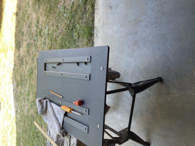

Prepping for new WM bags, and since my stock bags would pop out the engine dividers…
Attachment 30613
1x1 1/8 angle iron, cut to about 28” pretty close to the bottom channel and to not interfere with the upper locking nut and not scrape on the gel coat
Attachment 30614
Using the existing hardware
Attachment 30615
Cleaned up and drilled, stock hardware is exactly 10” apart
Attachment 30616
Filed down any sharp edges and painted
Attachment 30617
Installed just one per side to test…..
Continued due to 5 pictures per post
Attachment 30618
Attachment 30619
Have enough material to add a second per panel, plus some 1” 1/8 flat stock to utilize if required as well….
Was $24 bucks for enough material to make 6 angle iron brackets and 6 flat stock braces…. Surprised metal was still that cheap
I know everyone has done this a few times, and knows the issues…. I did notice on the front and back panels they had a small screw in the lower c channel holding them in place, but did not stop the front from popping out at the top after the middle had already pushed into the engine….

I'll second you guys here. Anyone looking to upgrade their bags, 100% need to do this. I got the WM upgrade initially and it's not working. In fact, those reinforcement pieces are bending. So, I'm in the middle of redoing it somewhat like this.
Have you guys thought any about the pressure on the fiberglass up top?
The top fiberglass edge has crossed my mind, but not too much I can do about that without a lot more work. I think it is stout enough to handle the pressure as is. That load is spread out along all the panels pretty evenly across the top. I had those panels bending and popping out with just the stock bags even before going to the WM bags. They are just too soft and flexible is the real problem.
I think its a concern because the load is focussed on the area where the two clips are at the top, thats a lot of pressure in a small space, I still have stock bags, and tested my single 1x1 angle iron on each middle diver panel, and the starboard side was ok, but port still popped in, I added the second angle iron to each middle panel today and will test that, I also have some flat stock I thought about using, perhaps up top to spread the load out, I will also think about the lower c channel screws, and perhaps even 2 more clips on the top of each side…. But I like to test things out 1 at a time to see what works….
As I mentioned still stock bags, but I will upgrade in the off season, so I am ok with building in some overkill…..
Are you guys using aluminum? That is what WM sells also.
Try to find 1" x 1" SST. Either 204 or 316 grade. It will be much stronger and run them the whole length of the panel not 3" short on each side like WM.
Also the channel at the bottom. Same thing use SST and add a few extra screws. Order deep channel. They make 1/2" x 1" channel that is 1/2" wide but has 1" sides to add height and help support the panel further up.
Lastly, just replace the panels with aluminum and cover them in sound deadener material. Add UHMW straps to the bottom to make them sit tight in the channel and at the top for the locks to work.
Just thoughts....but seeing these boats are new I get the frustration.
I used 1/8th steel angle iron for mine, was not going to go with aluminum…. Lol steel is just more ballast!! (I kill myself sometimes)…. I went as long as I could on each one….
