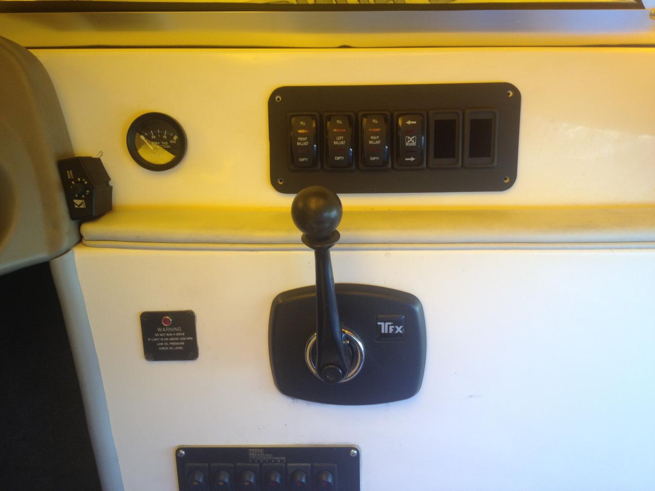

2- You should be able to use your existing switches with a little rewiring. Are you talking about 3 switches each with 2-way rockers (fill / drain)? With 3 bags you are still just doing a fill/drain on each.

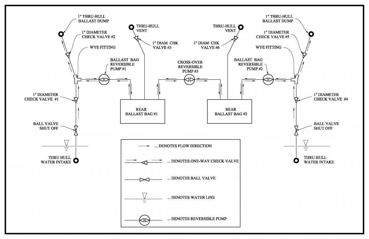

3- The little 750 drain pumps are most likely going to have 3/4" lines. You could keep and reuse those to save your budget a little. They can share a thru hull but ideally you may want them individual so you can tell which bag is empty and which is not if all are running. My setup shares a thru hull for the drain and vent (with a one-way valve on the vent line) for each bag - so 3 total. 2 Fill pumps can share a thru hull but they may end up competing with one another when running at the same time (mine do). Would definitely suggest 1" for the fill side. If you have the room and can keep them below where the water line is to ensure good priming you may want to go with individual thu hulls per pump. Sorta depends on your level of patience waiting for bags to fill too.
Then there's always the single reversible pump per bag option - somebody's sure to chime in on that.

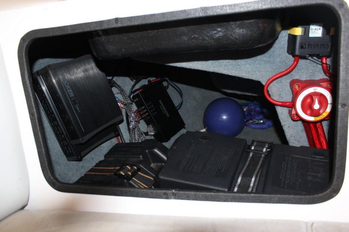

4 - I did the battery move a couple season's ago from the rear compartments to up under the glove box. Cabling gets a bit spendy but it is worth it to have full use of the rear compartments for ballast. Plus a necessity if you are going with 1100 bags with drain pump lines connected off the bottom rear at the back of the boat.
