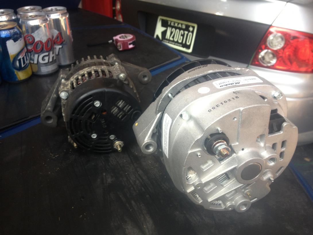

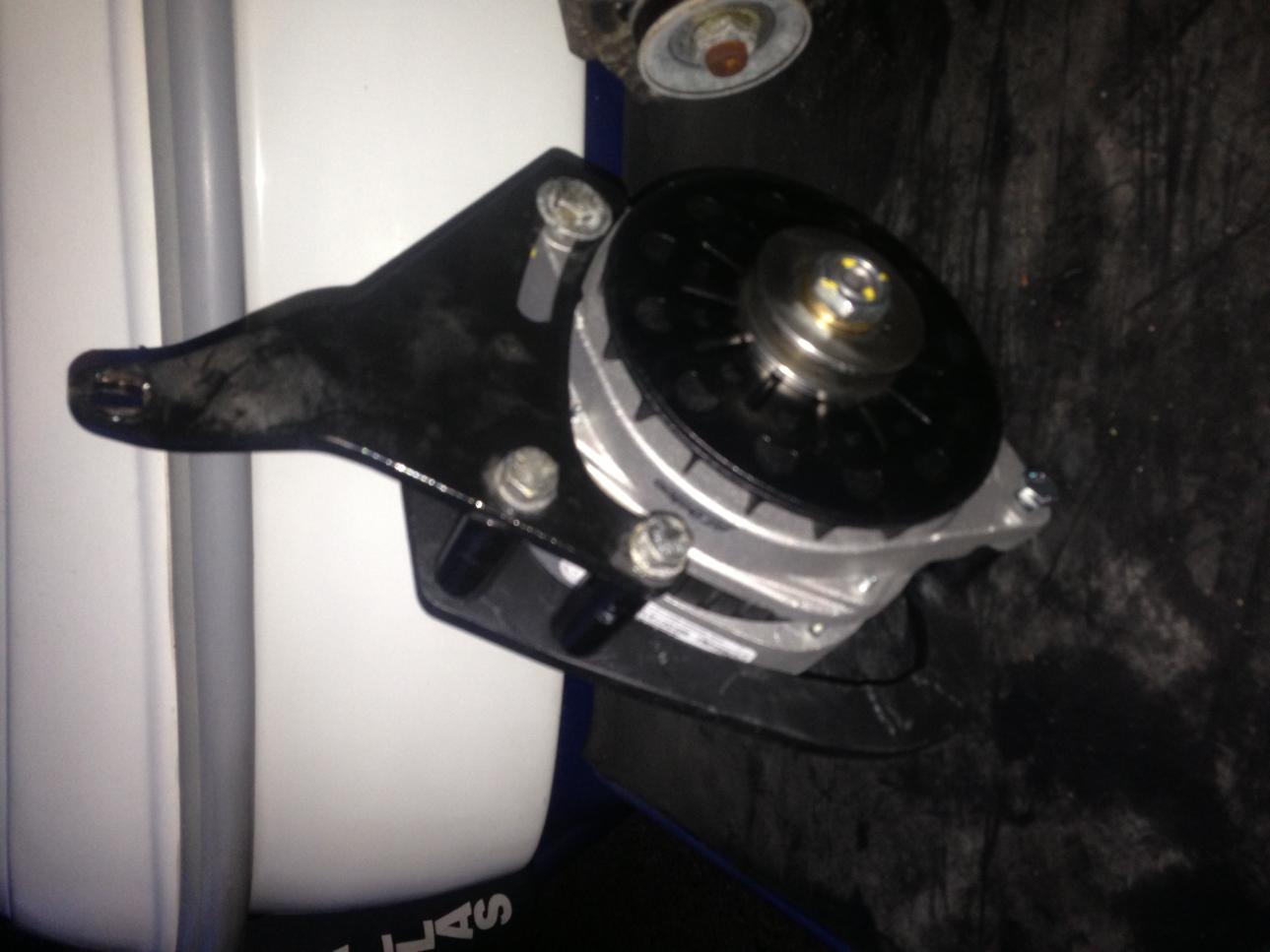

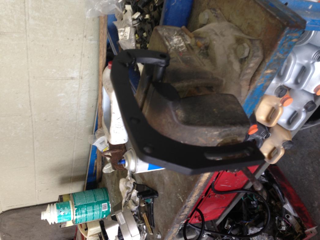

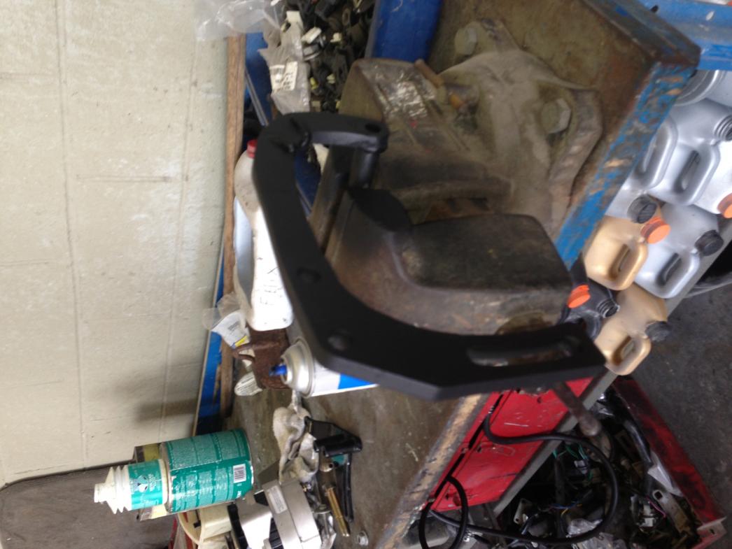

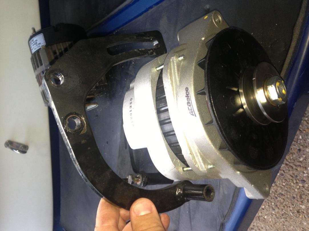

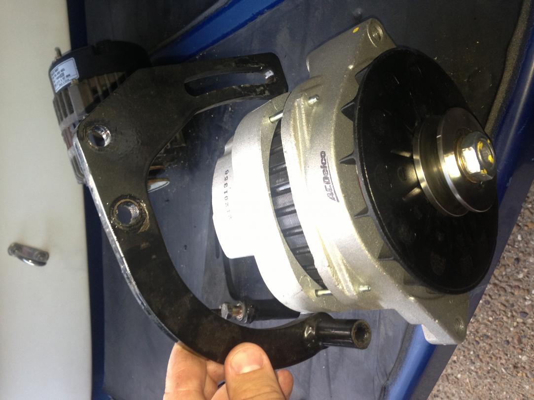

    Ok, so here was my problem. My alternator just couldn't keep up with the demands of the three exile amps. So, I picked up a cs144 alternator, it came with a serpentine pulley, I just took it off and put a smaller diameter v belt pulley on that I picked up locally. Tried to mount it, no dice. The bracket was too small to fit around the alternator. image.jpg

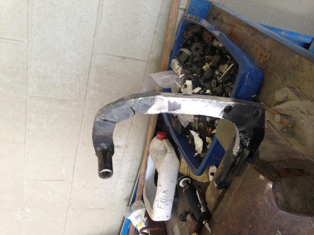

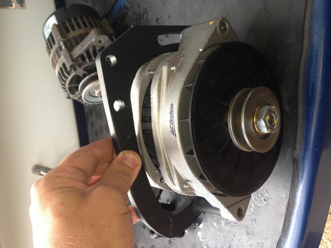

    Loosely assembled both brackets before squeezing it off in its new home image.jpg

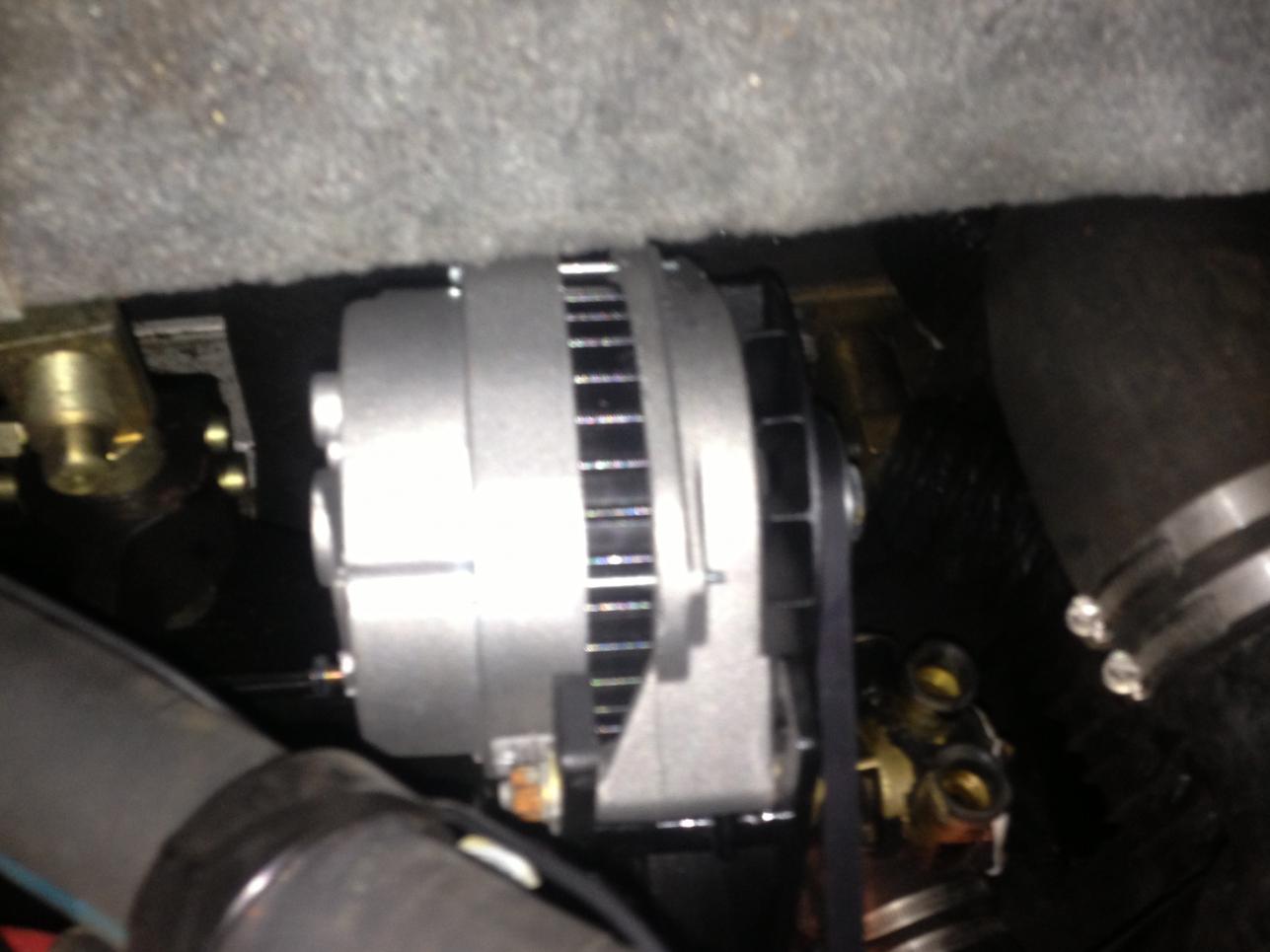

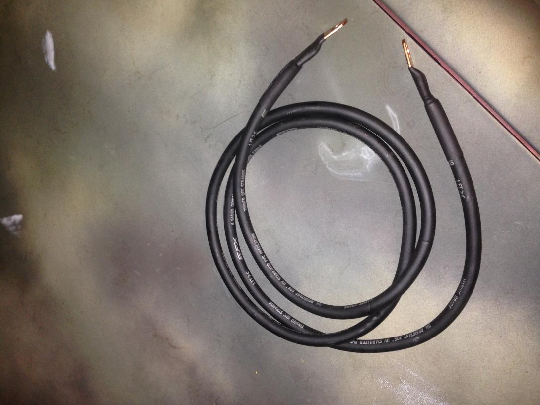

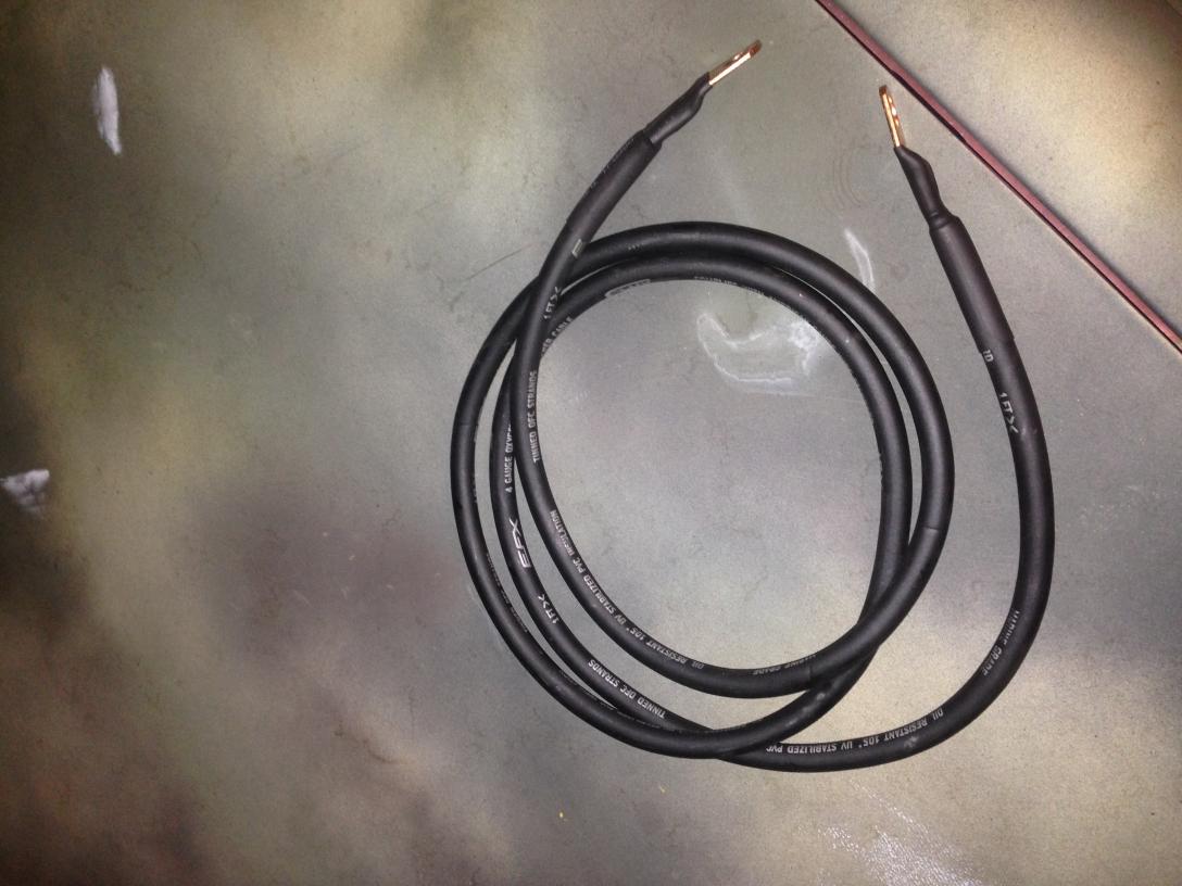

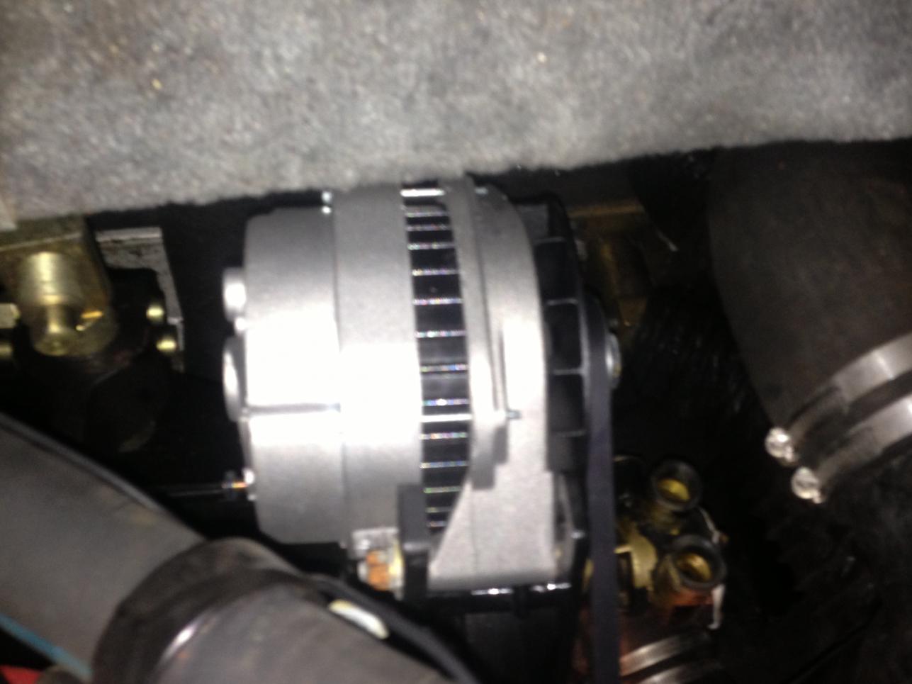

    Got the alternator bolted up and ran a piece of 4 gauge wire from the alternator charging stud to the starter stud.
    Then I wired up the pigtail for the new alternator I picked up at oriellys and put on a new gates belt. Then gave her a startup and she's charging like a champ. The difference in these alternators size is almost comical. image.jpg
