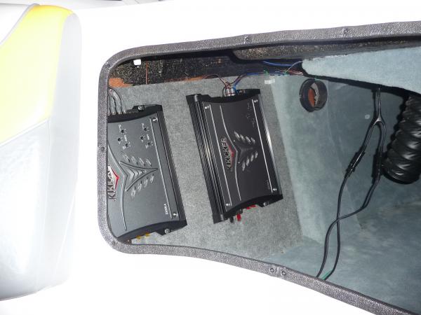

    To maximize storage and keep good airflow I'd suggest building a board to mount it/them under the glovebox on the side wall - keep the amps a few inches off the floor. Hide all your wiring behind the board. If you're getting water that far up inside I'd say the amps are probably the least of your worries!
    With your playpen front end and big basement locker storage there is a support beam that runs across near the front if it's like mine. This makes a good anchor point for any wiring or looms that you need to go from one side to the other that is out of sight and fairly protected.

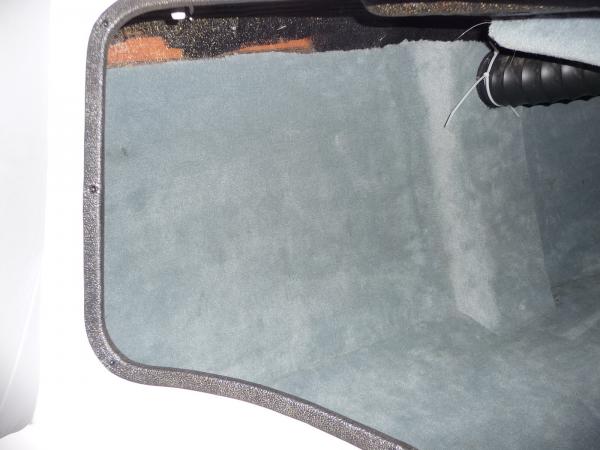

    Ah ha - from my ballast install. Here's a quick shot of that cross support. Behind the hoses going across you can see where wiring is routed and tacked up in there...
