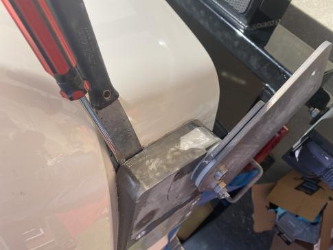

I got the blocks off with the marine debond suggested by Parrot (many thanks) , it took about 10 minutes per side. I sprayed the debond, let it soak, and then used a spatulas on the top/outside of each block the slightly wedge the spatulas in, then I used a flat head screw driver on top of that and lightly hammered and it came free.

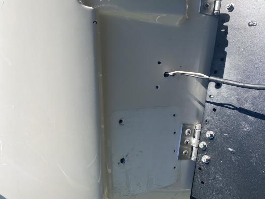

This is what your left with, some kind of white pad that I was unable to remove. I tried heat gun, debond, it does not want to come off.
Attachment 30057
So being the dummy that I am, and being forgetful, I drilled the holes for the actuator feet and tried feeding the wire through. That’s when I realized that the hole I drilled is 4” below the floor in the bag compartment.
Attachment 30058
Now I’m at a stopping point until I figure out what I’m going to do? Any suggestions are fine with me?
I would mock everything up and mark your mounts before drilling anymore holes.
The mistake can be glassed over when you fix the rest of the holes. A good glass guy can get the white pad off also.
The holes are in a great place for the tab, I’m wondering what is below the floor where the bags lay? I’m wondering if I can drill a hole a fish the wire up? It’ll be hidden behind the carpeted panel where the bag pumps are, just not sure what’s in that cavity, if anything?

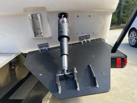

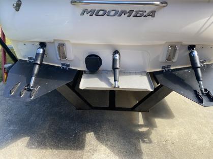

Redrilled holes and below is the result.
Attachment 30059
Attachment 30060
Since I had to change the location of the actuator feet, I asked Rob what angle the tabs should be at when deployed? He said that 10-15 degrees is plenty, I am at 13 degrees at the current location. He said more important is making sure that the tabs can retract up.

Those look good
Those look good. For the price that might be a better option then other systems I have look at.
Does this system have a "Launch" mode? (Deploys both tabs to help get on plane)
