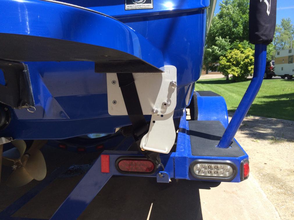

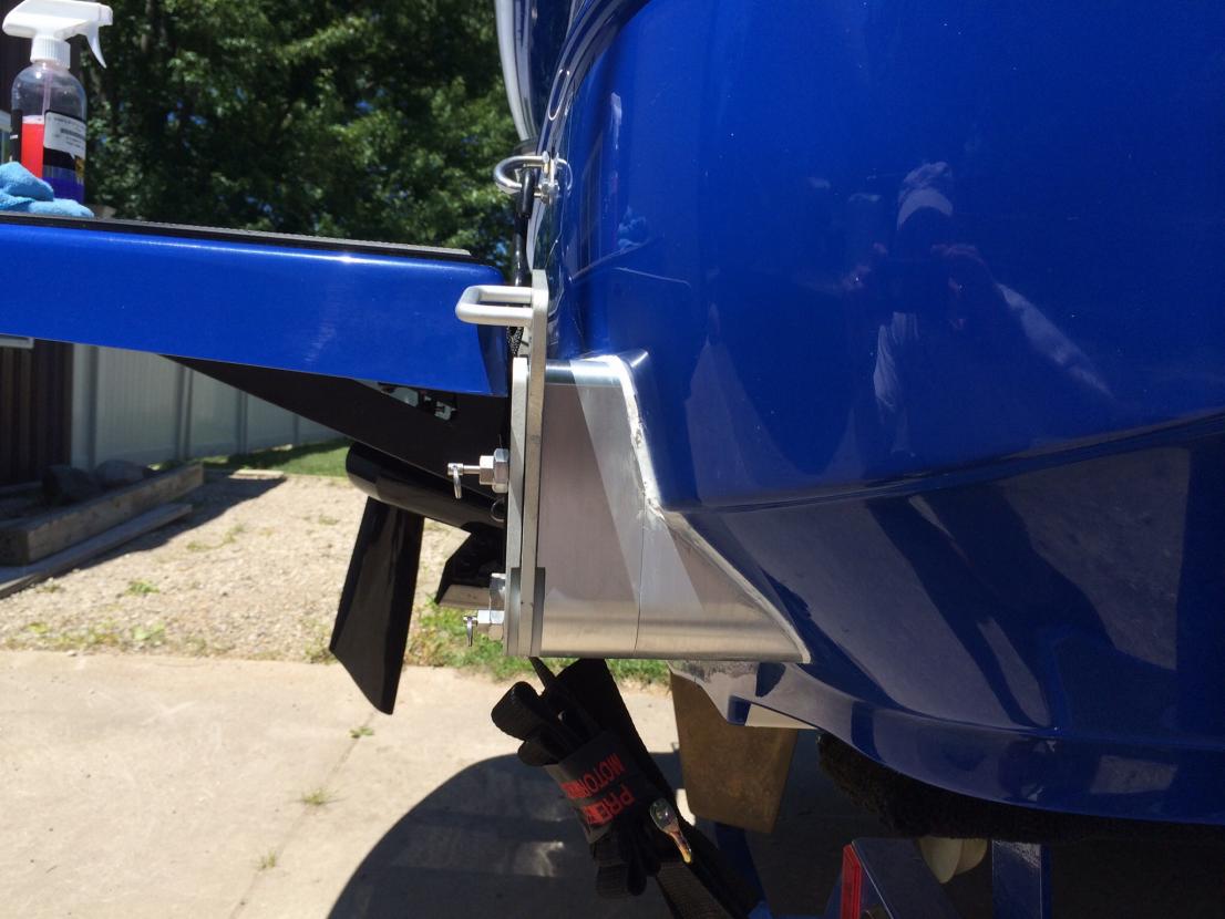

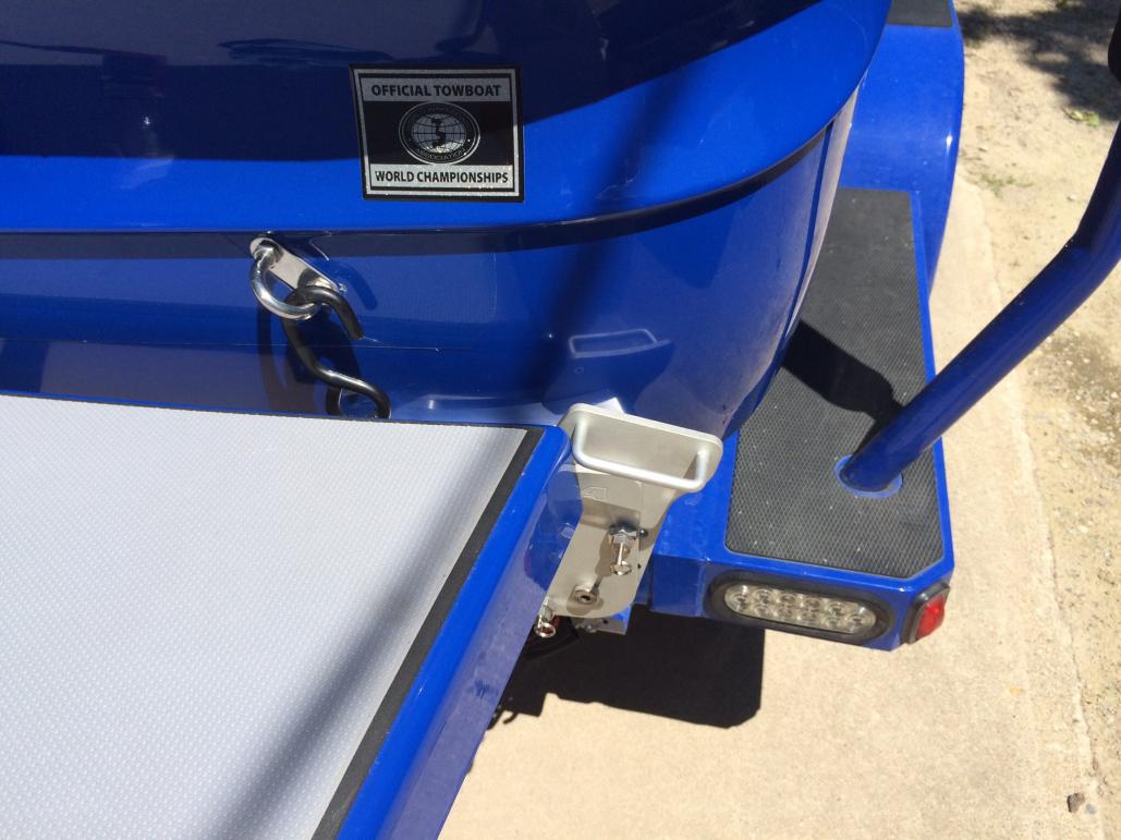

Just had the "Flow" installed on my 08 LSV. Be aware that the older swim platform will not fit once you have the flow installed. I had to push it out about an inch to get it on the boat, even after doing this the Flow is not able to be place in the "Stored" position.
Testing out the flow, no pictures yet, and ended up getting squirrelly water off the platform. It appears to lengthen the wave, but will need to surf it to know for sure. Had ~700 at the bow, and ~600 in each rear bag.
Currently have a new swim platform on order, so add the cost of a new swim platform to the cost of the flow if you are installing on an older LSV.
Attachment 20342
Attachment 20343
Attachment 20344
You can make a platform, I just got my sheet of HDPE 1x24x48...$144 with shipping..
Let me know how the flow works, been waiting to see how it works on the LSV...
https://www.interstateplastics.com/H...calculate.y=18
Too bad the handle isn't removable, that would be a simple solution.

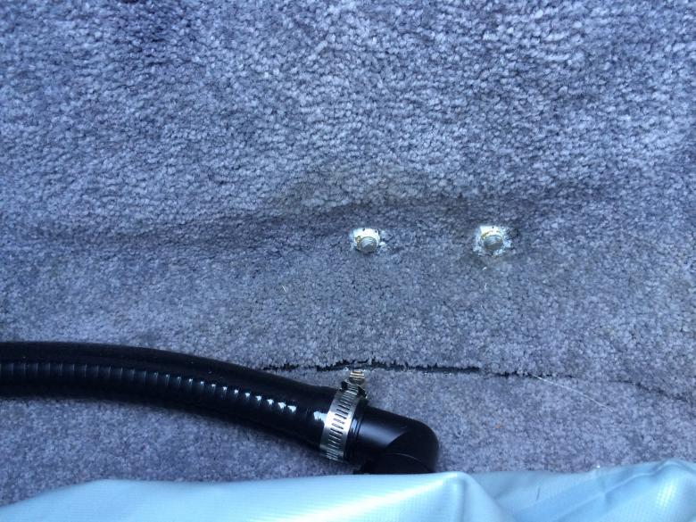

Here is the pic from in the rear locker.
Only has two nuts that are exposed.
Attachment 20391
The handle can be removed, and would be able to fold up. Looked at doing this, but did not find a suitable replacement yet.
