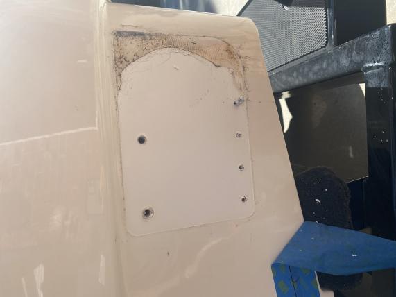

I got the blocks off with the marine debond suggested by Parrot (many thanks) , it took about 10 minutes per side. I sprayed the debond, let it soak, and then used a spatulas on the top/outside of each block the slightly wedge the spatulas in, then I used a flat head screw driver on top of that and lightly hammered and it came free.
Attachment 30056
This is what your left with, some kind of white pad that I was unable to remove. I tried heat gun, debond, it does not want to come off.

The mistake can be glassed over when you fix the rest of the holes. A good glass guy can get the white pad off also.
