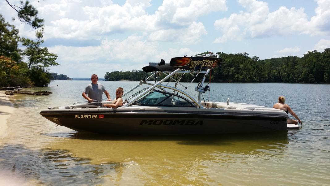

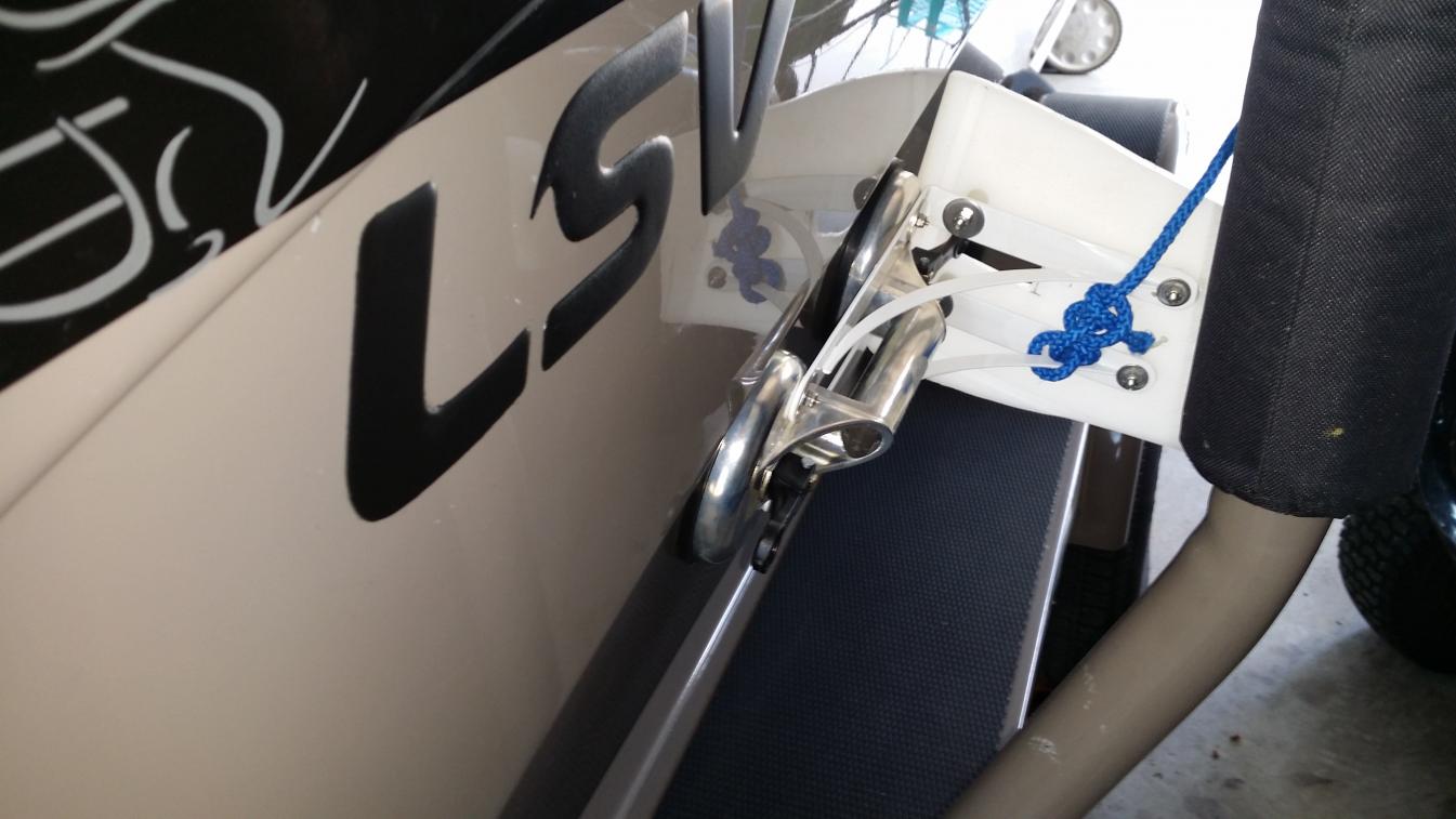

If anyone still has the letters from this thread lying around you no doubt recall that the small letters worked great but the larger MOOMBA letters did not work out and ended up with a "hammered" appearance despite best efforts in installing them. Well, I dug out the box a few weeks ago and had my artistic daughter work with me to get them on the boat. Then we plasti-dipped them black. The result was very good. Pics below.
The only problem is that the edges on each letter are beveled down so far it was impossible to just peel off the plasti-dip to remove it from the hull around the letters without also peeling it off the letters themselves. Our solution was to apply 3 coats within about 10 min of each other then wait till the third coat was still slightly tacky or just barely dry but still soft. She then traced or cut an outline of each letter with her fingernail and/or a small plastic edged tool to make a nice clean edge. The plasti-dip could then be safely peeled away. This made for a bit more work to get a good final result but we were very happy with the look and once we had a system it went a little quicker.
Anyway, the thickness of the plasti-dip combined with the matte finish completely negates the hammered metal look of the chrome. So, if you still have your letters you can copy this method with a good result or sell them in good faith to someone who wants to plasti-dip them. Hope this helps someone.
