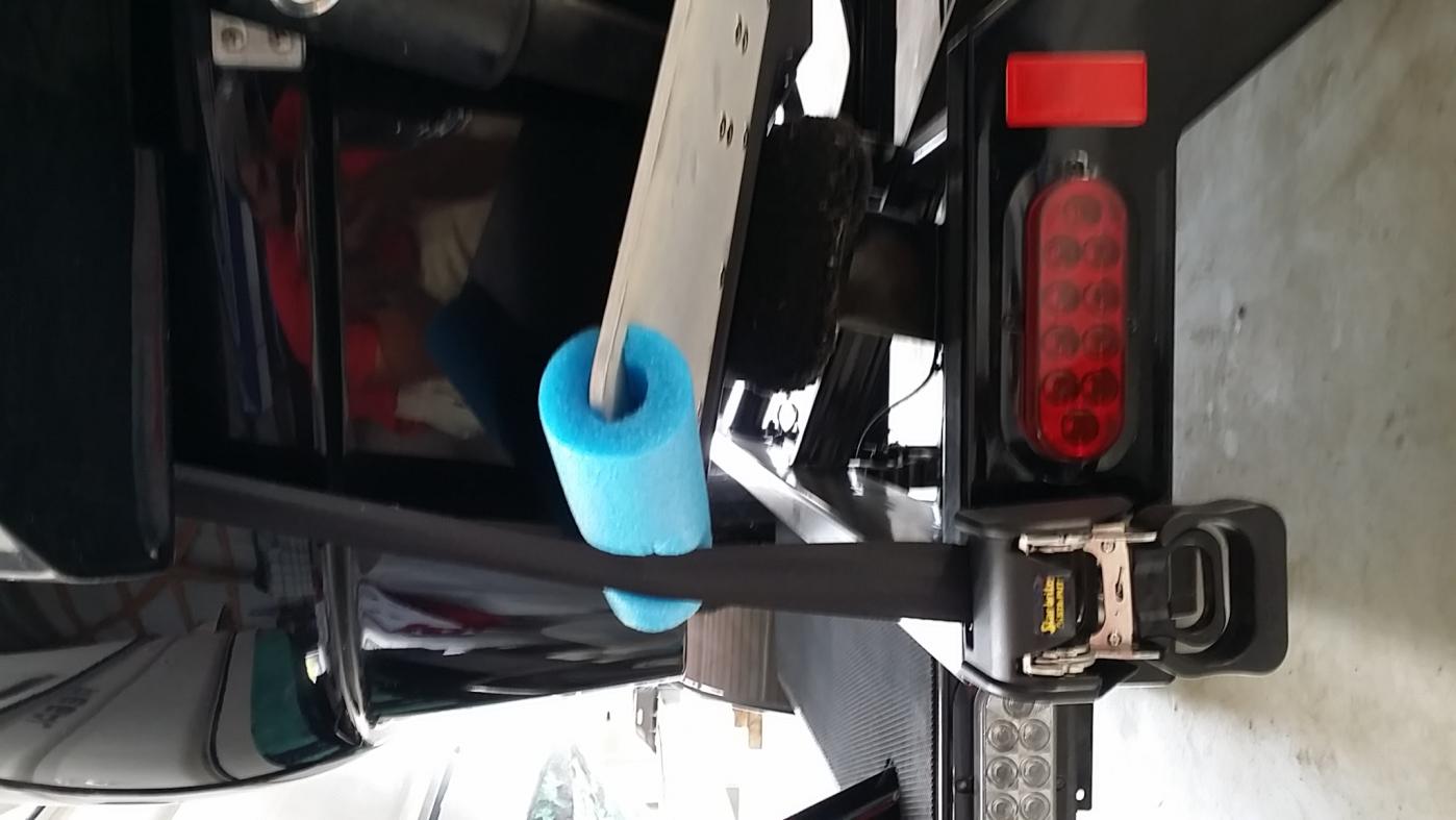

For people who upgraded from Auto Flow 1.0 to 2.0, how do you hook up your transom straps? It looks like the new bigger plates will be in the way.
I cut a slit in a pool noodle, attack to the tab to not chaf the strap,and not tighten as much. The only picture I have is this one with the old tab but you get the idea.Attachment 24260

On a 17 so I have the hooks on swim platform, but I used gates hydraulic hose sheath to cover the strap, pretty clean , seems to get the job done, no wear so far https://uploads.tapatalk-cdn.com/201...60df1e3c19.jpg
