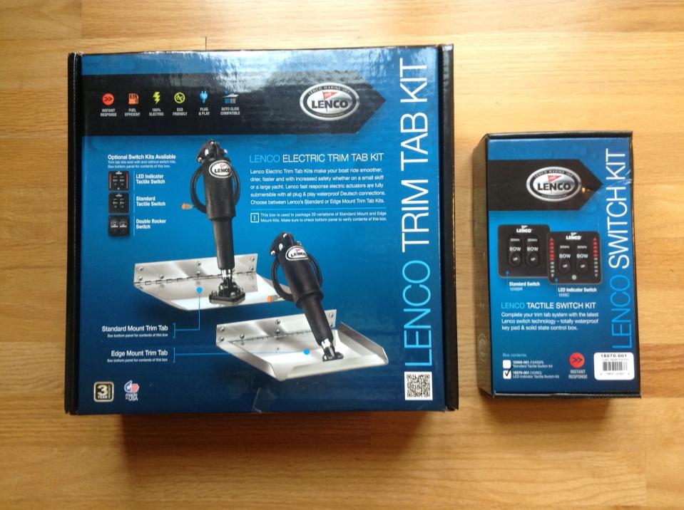

I am thinking of trying the Lenco 12"x9" tabs. 12" long 9" wide and the indicator tactile switch kit so I know where each tab is like what the guy had shown in the first part of the thread. I would power this switch with an extra rocker switch on my panel (when the controller loses power it automatic bring the tabs to the full up position.
I was thinking I would try them stock out of the box if that was not good enough I would try and re-shape them later.
Since our season is pretty much over I was going to wait till black Friday or cyber Monday to try and order them. maybe get a little better deal on them.
Mastercraft is using Lenco tabs so I thought about calling Lenco saying I messed my tabs up on my x10 and see they would sell me them.
