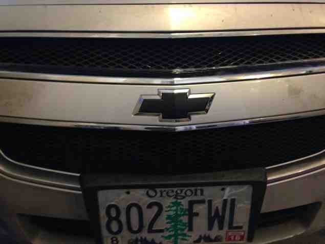

Picked up an can and dipped my company car emblems.
Cool stuff!Attachment 16745
http://img.tapatalk.com/d/13/01/22/2yjy7u8y.jpg
Very easy. I found that I don't need to tape close at all. It does help to have a little warmth to the air. It did not want to cure with the garage around 50 degrees. I warmed it with a hair dryer for a couple of minutes and then it was good to go.

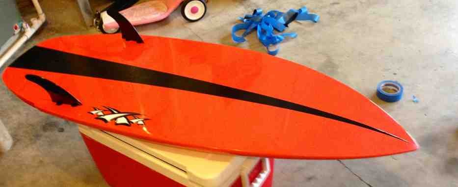

Just for the fun of it.Attachment 16753
looks sweet Boone!
