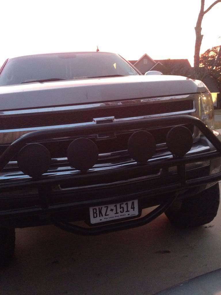

    They have a gloss finish you can get for it but I'm not sure how easy it will be to remove the plastdip if you put the gloss coat over it. I use the flat or matte black (whatever they call it) on my truck emblems and hella cover lights. It really is cool stuff. I messed up on the rear emblem so I peeled it all off and started over. Very easy to do. Problem I had was when I removed the tape the plasti dip peeled off the emblem because it attached itself to the tape. The fix for that is use a razor blade or toothpick and make sure the plast dip if removed from the tape
    Covers were white with black lettering
    Bow ties plasti dipped (before debadging)
