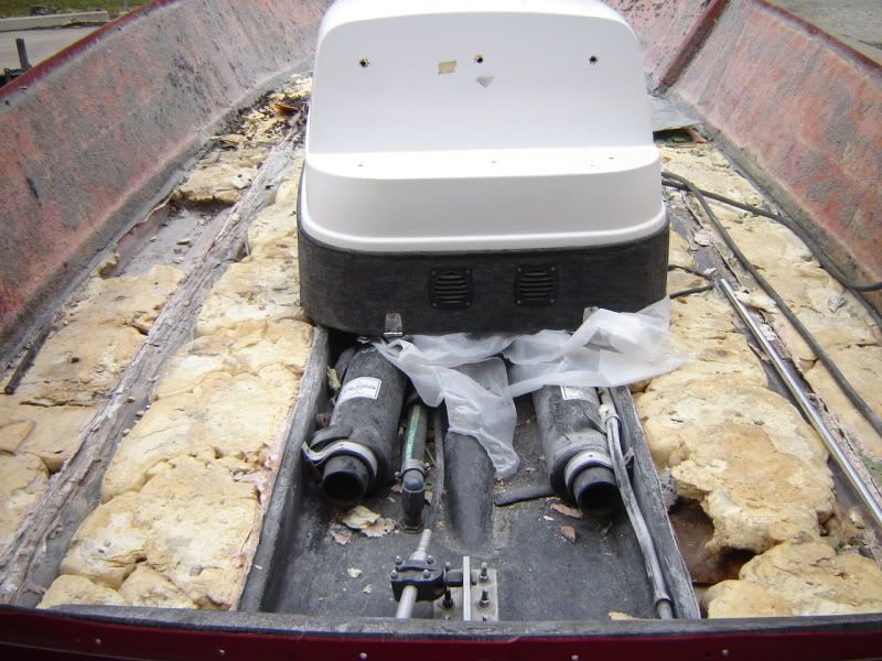

Getting it all put back together, got the ass end buffed, polished, and got the speedo pickups and hoses installed. Put on new exhaust flappers since there weren't any on it when I bought it. Got the motor cover carpeted with new rubber, bilge pump installed, got all the wire routing figured out, windshield is installed with all new gaskets, screw cover foam, bumpers, latches and siliconed around it on the hull. Also put in all new fresh air/bilge vent hoses and a new battery in a box instead of sitting in a tray.
