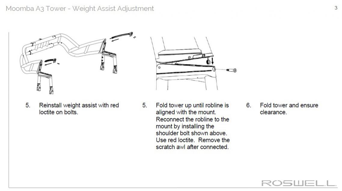

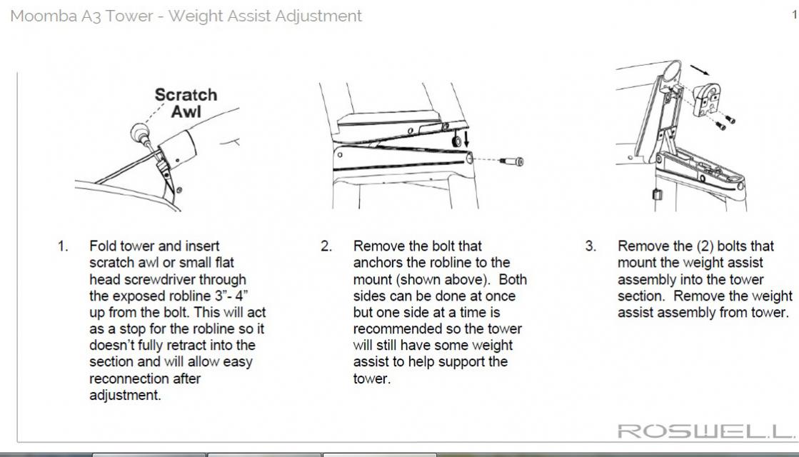

I got a reply back from Roswell. This is the procedure they sent and it worked perfect. Hope this helps, just be sure to do each side separately so the tower doesn't fall.
Attachment 26284
Edit: Please see the post below for larger image.
From the post above, I tried to resize the instructions up a bit:
https://forum.moomba.com/attachment....5&d=1507118596
https://forum.moomba.com/attachment....6&d=1507118613
https://forum.moomba.com/attachment....7&d=1507118629
Attachment 26285
Attachment 26286
Attachment 26287
