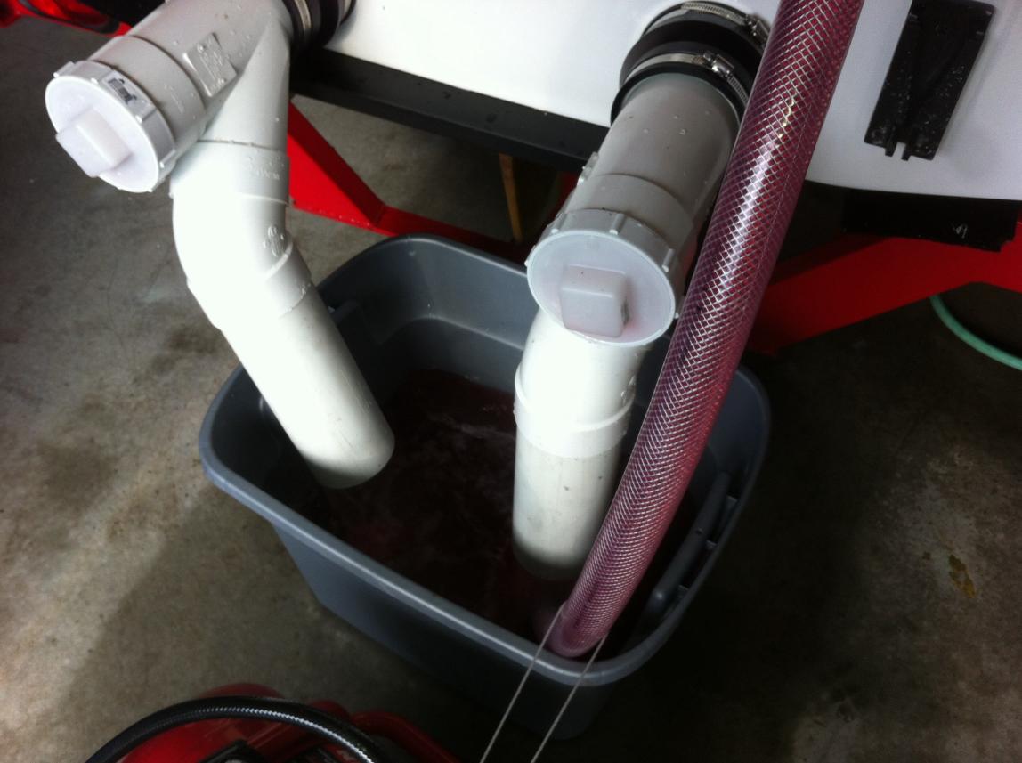

    Hi all,
    I have a 2006 outback. I also use the recirculating system and it works perfect. I do not drain the antifreeze from the block. My boat is in my garage all winter long and is always over freezing point....my car is outside freezing (I'm from Quebec...).
    I don't have that blue hose for the dripless seal. I think that's new starting in 2007??? Right ?
    I will have a new 2014 Mondo next summer. Will I have a cooling line for the shaft seal??
    Thanks
