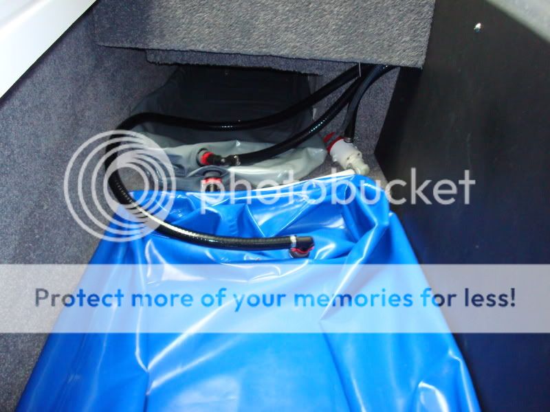

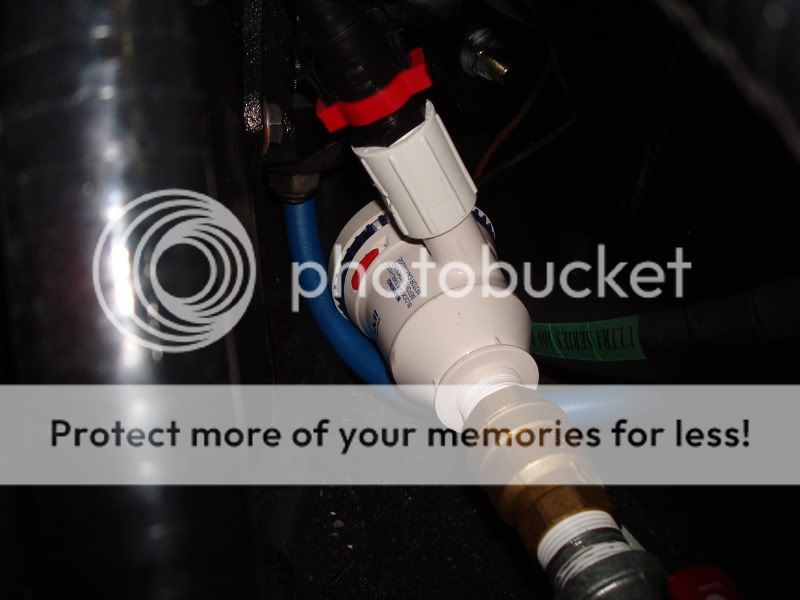

    Jon J, my system is a little different than Newty's. What i have done is add the tee fitting with the orginal pump feeding the gravity 3 manifold, the 2nd pump is a tsunami 800bph pump that feeds directly to my surf ballast bag
    here is a photo of the tee
    this is the tsunami pump- i resused the factory fittings on this as i had them-
    this is were the hose goes into the bag- i have this pump on a seperate switch for power that way i can undue the hose to burb the bag if needed.
    in this photo you can also see my underseat bag.
