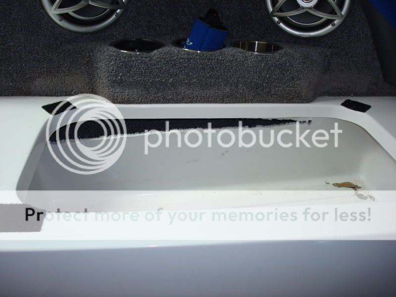

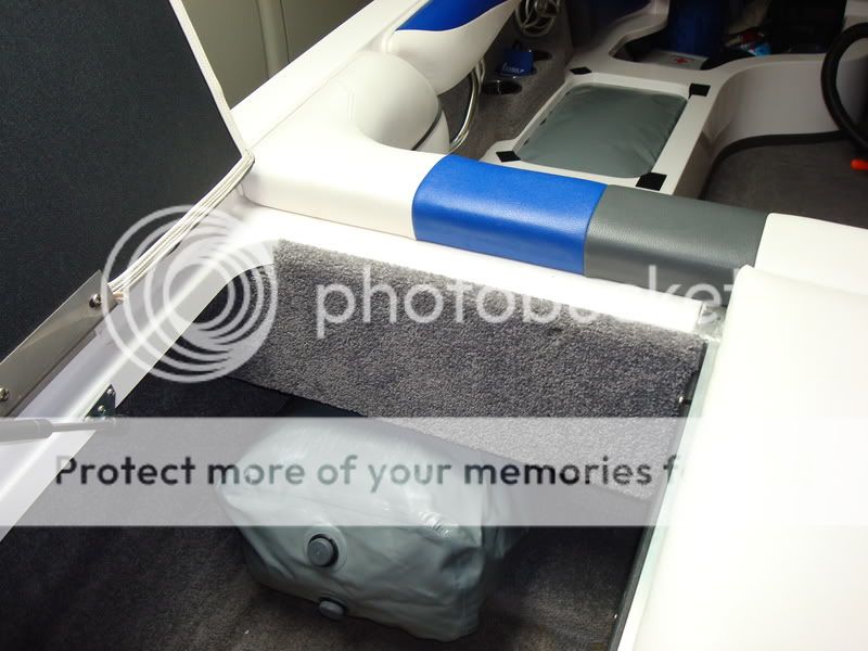

    John- sorry i just saw that all the photos in the other thread are gone but this is what i did.
    dremil to cut with
    cooler begining to comeout
    rear gravity 3 bag under the seats- i plummed it in
    rear surf bag and under seat bag filled iwth air for the photo
    Hey, Its Moomba time

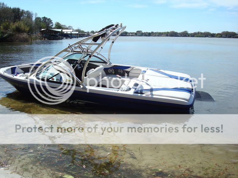

    this is what it looks like all filled up
    also put a 400lb bag on the seat
    hope this helps with your mod

    Still working on it, think i need more weight up front. Looked like the swim platform was still draggin in the water. Other issue i had was the lake level--its low
