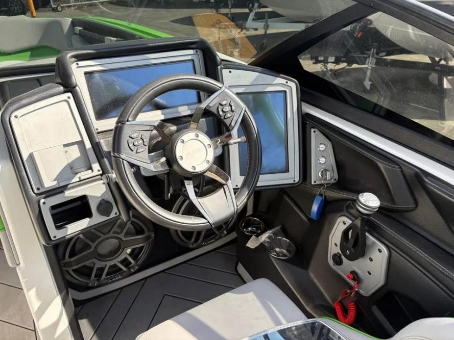

    The Supra boats forum sucks and this forum looks pretty active so I'm gonna ask for some help. Just picked up a 2019 Supra SA450 a week ago. I have a pretty nice stereo in my truck and so I was really shocked at how bad the OEM Supra SA stereo was! When we did the lake test the owner cranked the stereo and made me listen from the swim deck and it was cringeworthy!
    For subwoofers, has anyone done a similar installation to the picture in the link below with 2x 12 inch JL M7-12IBs in free air? Would love to see more pics of a similar installation with trying to seal off the front to the back.
    I don't think I have permission to post photos so here is the link:
    https://olympicmarineandrecchilliwac.../#lg=1&slide=6
    Yes, they lost some foot space under the helm but I'll gladly take that for more bass/impact. I'm pretty sure I heard this same boat on Osoyoos lake in BC and it pounded pretty good. Problem is that I would really like to use a JL 12 with the lights to keep the whole interior consistent with the lighting. Sealed would require like 3ft^3 and ported like 5ft^2... any info would be much appreciated.

    I have a single 12 under the helm but mine is in a sealed box I built. I used the front panel as the face and added the box to it. I lost no feet room but was a bear to get in.
    There are custom installs with ported boxes in the same location but you give up most to all feet room. The "infinite air" subs do not sound good if you want punchy bass like your truck.

    I ended up searching the fb group and found several posts over the past few years with setups. Mostly ported in both the helm and port side cubby area. Once I get my old boat sorted and ready for sale I'll start thinking about this more seriously.
