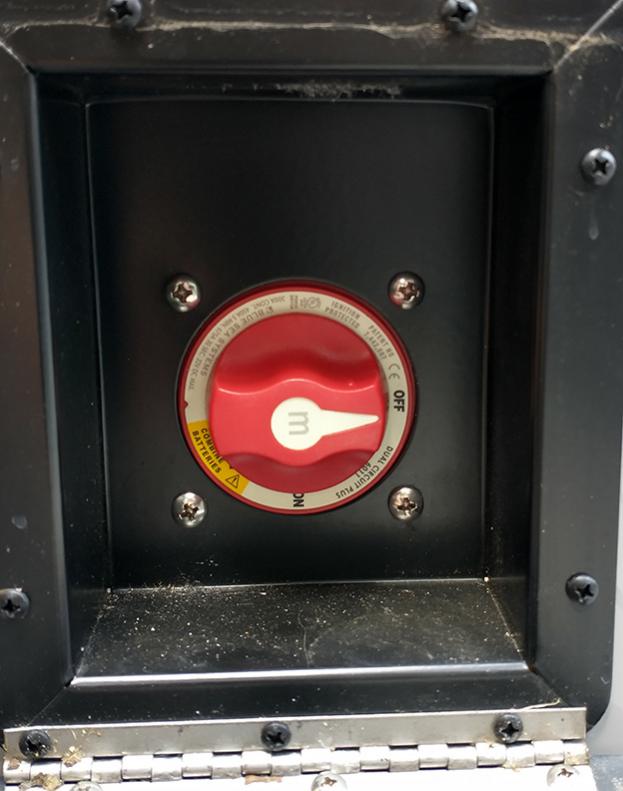

Here is the switch, fits in the factory spot.

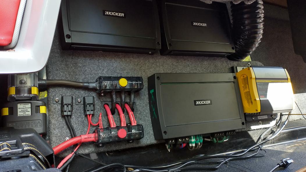

The ACR.
Didn't quite fit on my amp board, but my charger did.
