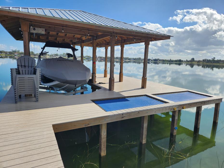

    My setup

    Nice setup... looks like you have dual driveshafts? Any reason for the lack of risers off the cradle... shallow water accommodation?
    I'm going with a single motor 8k cable lift, but the driveshaft will run horizontally across the slip at the front of the boat. I definitely wanted to make sure there was a good sized pocket to lift the boat into without messing with dropping the bimini every time. Forgot about the board racks though... slip is going to be ~11 ft wide, so I'll have to swing them in before pulling in.

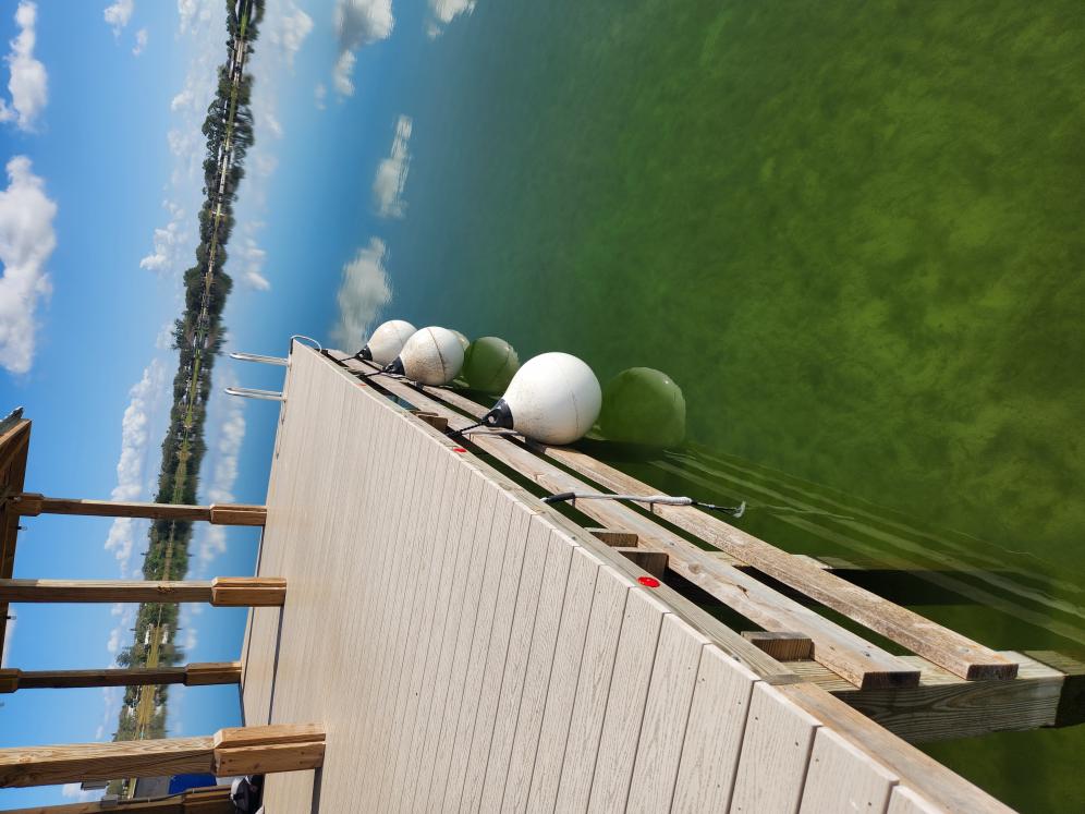

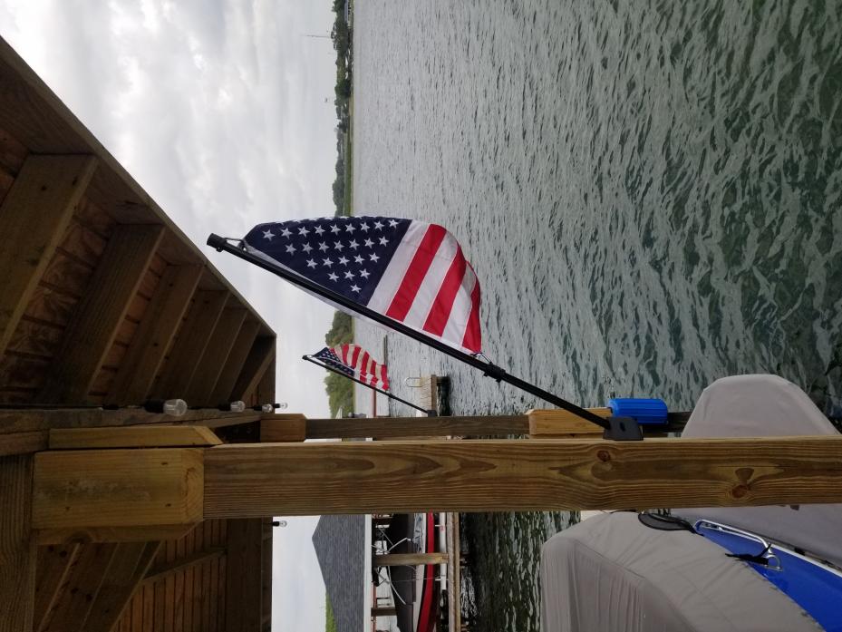

    Have plenty of height inside to raise it up to protect from rising water, sun, weather, etc. Make sure they put the poles into the ground plenty deep so they don't sink from the weight of the boat and warp your dock and do cross bracing. Pay the extra for composite and if your wife likes to lay out then built in hammocks are $$. American flags to read the wind when docking. Place to tie up when you don't want to put it on the lift.

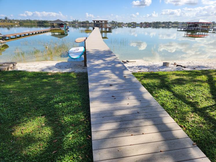

    Also have the dock go into ground level vs a step. Makes wheeling the gas caddy out much easier.

    Going with TruFlow decking to try and combat the scorching bare foot surfaces in the middle of Texas summers. Those built in hammocks are pretty trick! How many times have you eaten up passengers in the hammocks after exiting the boat after a few too many adult beverages?
    Our lake levels fluctuate pretty dramatically over the course of the season, so any tricks to managing the dockside tie up system to accommodate? I guess you can keep tacking on skirting as the levels drop so your bumpers have something to push against.

    Our water fluctuates about 6 feet on average throughout the year so yes i will add another skirt if needed and adjust the mooring balls as needed. The hammocks are constantly occupied. Good cool place to take a nap with the breeze under you.
    I pull up to the side with bow in so people exit on the other side of the dock from the hammocks. The let's tie up balls all popped but they were not being used as intended so my fault. The mooring bouys have been great.

    I am in only in about 5 ft of water at my dock, so that's why no spacers between the bunks and crossbars. Don't need them. I have dual drive shafts because the guy who put it in over engineered it. Each shaft has its own motor. 8K rated lift. I don't have any cables going across or rather over the boat. No pulleys, so each side just winds the cable straight around the shaft. It lifts fairly fast that way, but it has two switches and I have to be mindful to keep each side level. A single controller to regulate two motors is pretty costly, so I just keep an eye on it. Lift came from Boathoist USA. We generally load and unload with the boat lowered in the lift and just barely snugged on the bunks enough to keep it stable. It puts my swim platform almost even with the dock that way. Just have to hop across the gap. I sometimes put a carpeted covered 2x10 across the gap like a small bridge from the dock to the swim platform for some older people who can't step that far. My slip width is also 11 ft wide and I always just pull into the lift and snug it up by rasing the bunks till the boat bottom is barely at water level to avoid waves from rocking it. Always parked in the shade that way.
