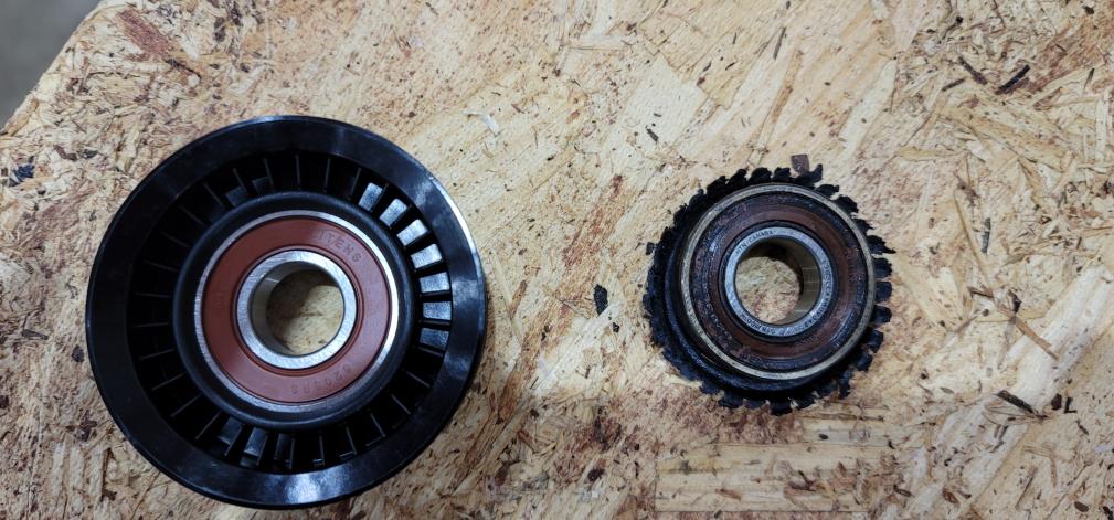

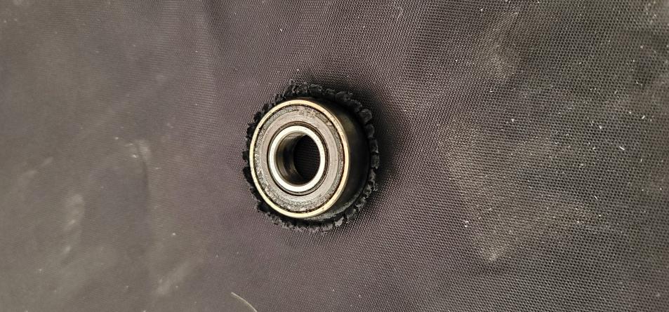

    Here is what was left of it.
    I found the belt P/N 725901
    Anyone have any idea how to find the idler pulley part number?
    Indmar 1662357 is what I get off the Australian website.
    Indmar 551246 is what I got off parts site.
    I know 2015 had the extra lower idler pulley but not sure what to buy.
