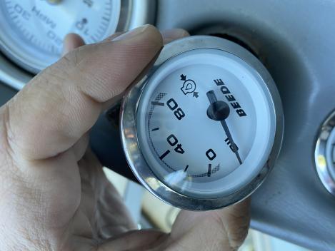

    Default Oil Pressure Gauge
    Does anyone have one of these laying around they would sell? I can’t find one and would prefer an exact match if possible. My gauge dropped to zero yesterday.

    Did you verify power to the system and the operability of the sending unit? There is one on eBay through Greatlakesskipper.

    I have power to the gauge. As for the sender, what is the best way to test? I did disconnect the sender wire thinking the gauge should jump to max, but nothing.

    Check out this video for testing the sending unit:
    https://youtu.be/xbJmRERZUSg

    Ok so I am getting a steady 252 ohms at no pressure, assuming that rules out the sender?
