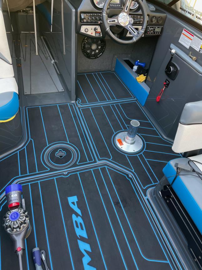

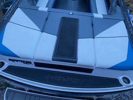

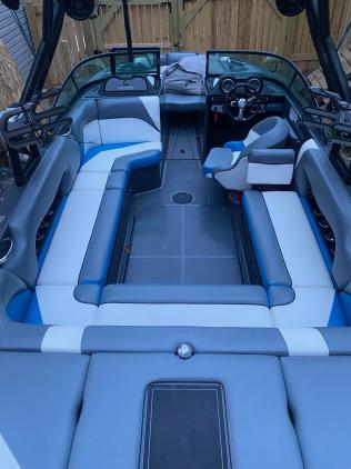

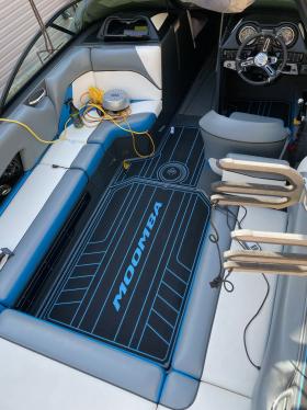

    The snap-in rubber floors flew out during the drive bringing her home, so step one was a full GatorStep installation:
    '16 Moomba Mojo Surf Edition
    1275 WakeMakers Rear Ballast Upgrade
    GatorStep

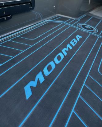

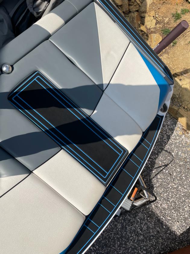

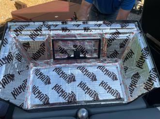

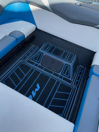

    Limited on file upload per post, so here is more of the GatorStep after installation:

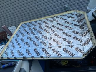

    While cleaning and applying GatorStep (very easy process, just take your time) I went ahead and added sound dampening to the floor and V-drive cover. Very worth it IMO!

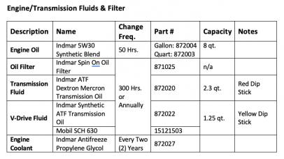

    Conducted and oil, oil filter, V-drive, transmission, and coolant fluid change(s) at the start of the season. Made the chart below (can't figure out how to upload PDFs?) which now hangs in my garage along with similar cheat sheets for other vehicles/engines.

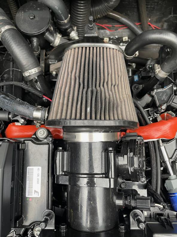

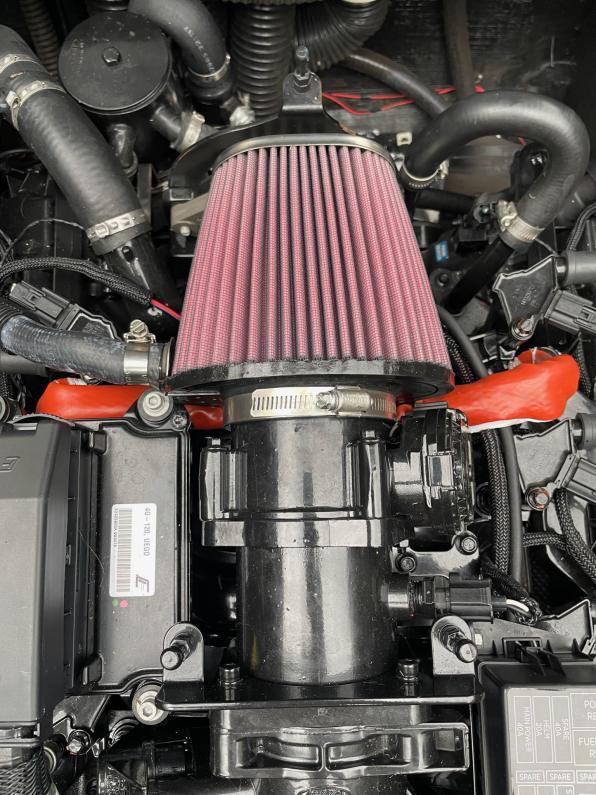

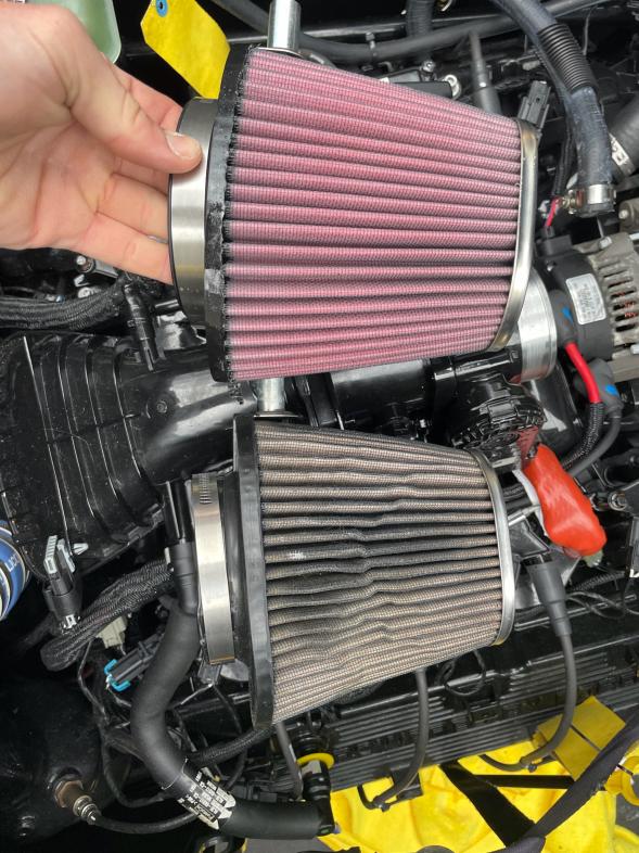

    Also swapped out the flame arrestor, and I was blown away at the difference between the new and old! FEA2B66F-4EB6-4461-BFB1-793EA4175997.jpg

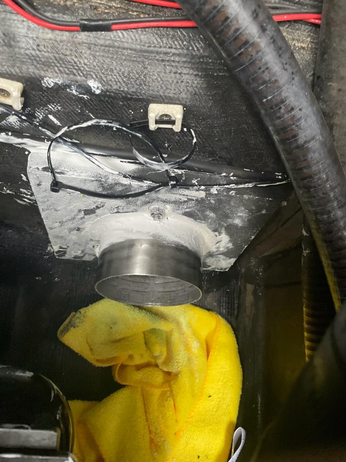

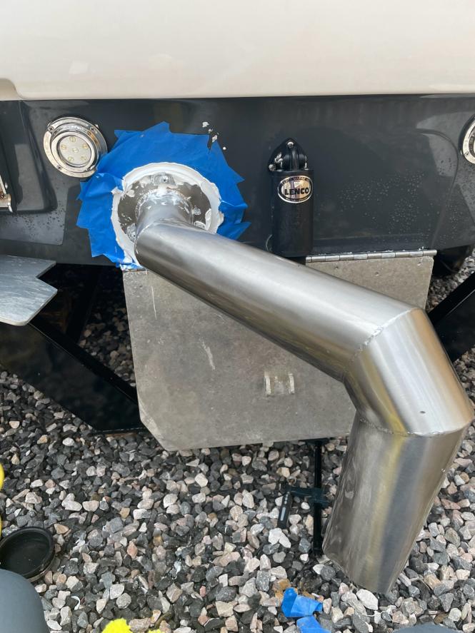

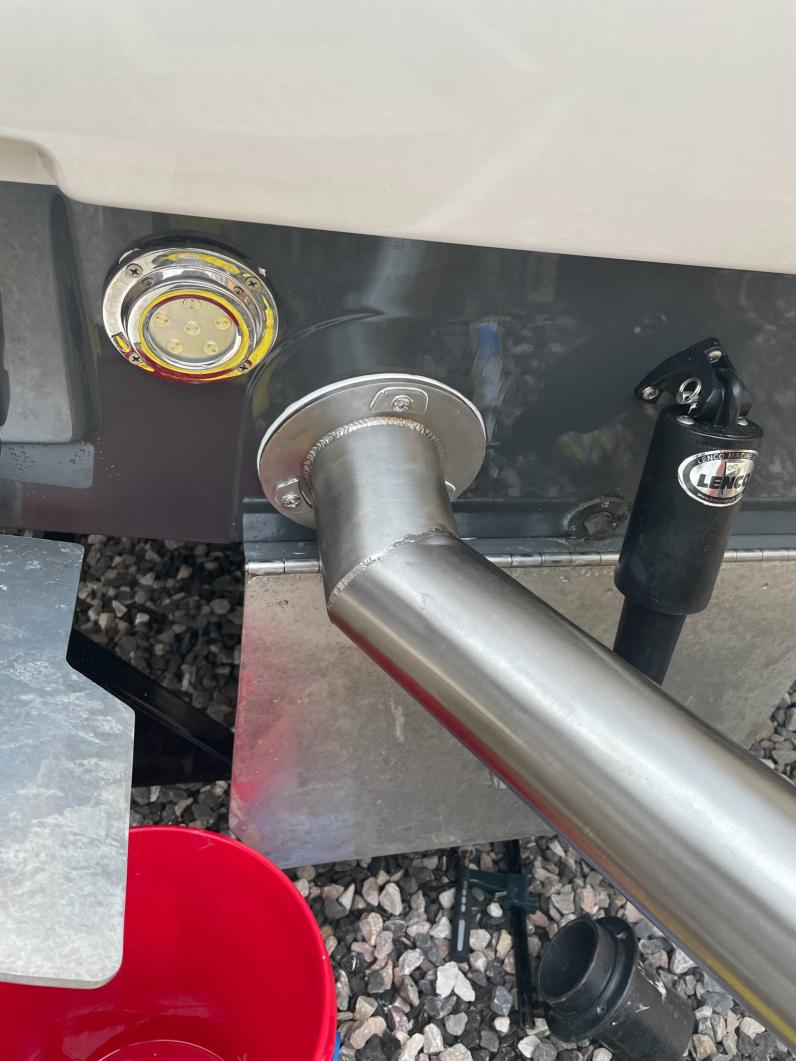

    Also ordered and installed a FAE. This is not an easy process but if you go slow, follow instructions, and "practice" the installation (before doing it with the sealant) it will go smoothly. As the instructions say, be very liberal in your application of the 5200 sealant. It should look messy right after you finish and you can easily clean up later.

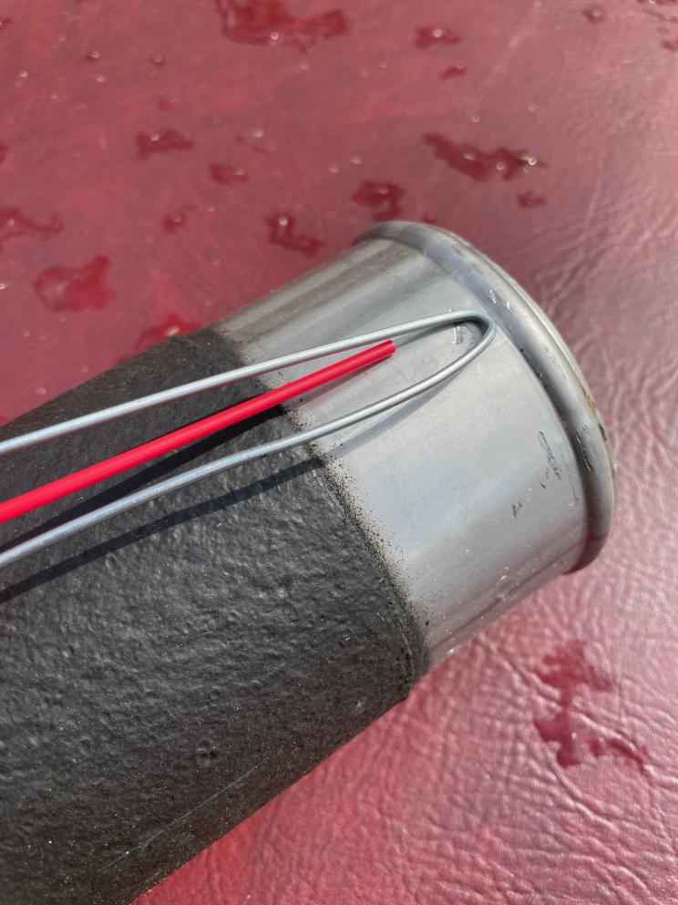

    I also purchased the upgraded baffle, which is a serious pain to remove. That said, one *major* suggestion/tip/trick for removing the stock baffle: Take a wire coat hanger, bent it, and pushed it up between the stock baffle and rubber exhaust rubbing, with the straw sprayer of WD40 in between, (see picture below). Spray some WD40 once inserted. I did this in 3-4 areas working my way around the baffle and it slide right off like butter.
