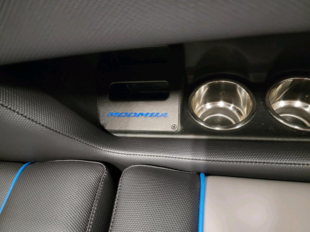

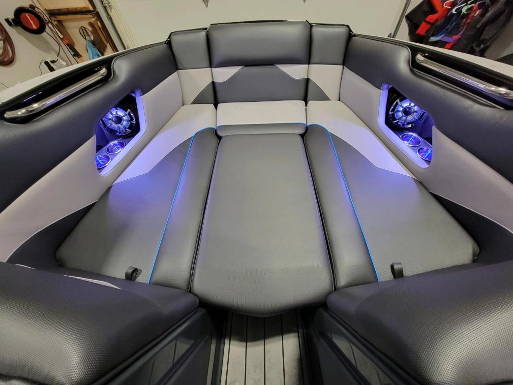

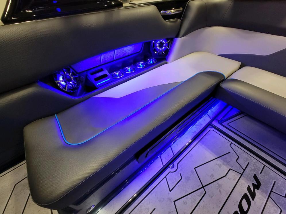

    so after finding out the RGB controller has 4 outputs, and only 2 were used, i decided to add some more light. I also fixed the 6.5 speakers so they are RGB tied to the tower speakers, they were set to blue with the courtesy light switch.

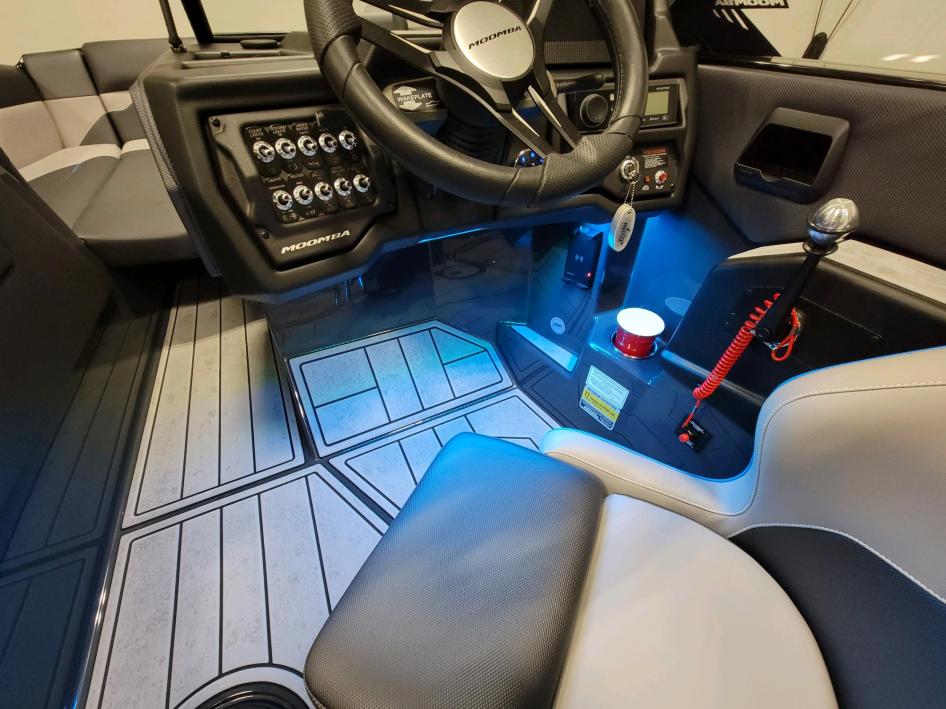

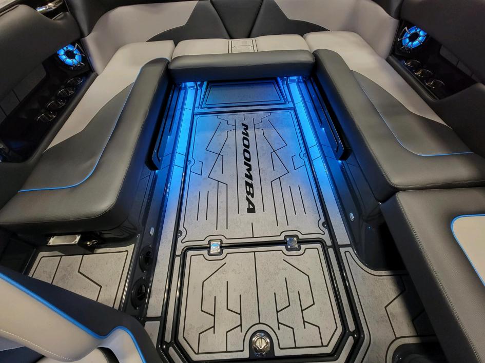

    Added strips under the seat track, and another under the steering wheel.

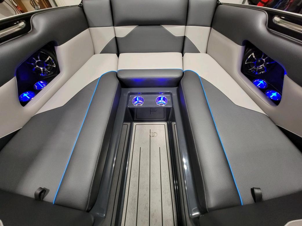

    I also added 5mm blue LEDs to every cup holder except the back 2 and drivers.
    and added blue vinyl to the phone holder plates with a backlight. They turn on with the courtesy lights.
    I may also add some LED strips to the larger compartments to help find stuff in low light.

    thanks. i just used flat top blue 5mm leds with a 400ohm resistor on each one, i had 2 pin molex minifit connectors so i can remove them individually if needed for cleaning. the LEDs i got probably 10 years ago on ebay, super cheap.
    I just drilled out the drain hole so it was a snug fit and the led was flush to the bottom of the cupholder (affects lighting if its not flush) and black hot glue to hold in place.
    i thought about doing the 2 on the transom, but i know water is going to get dripped into them, and then they will just fill and be annoying, so i may do rings on those, probably just leave them.
