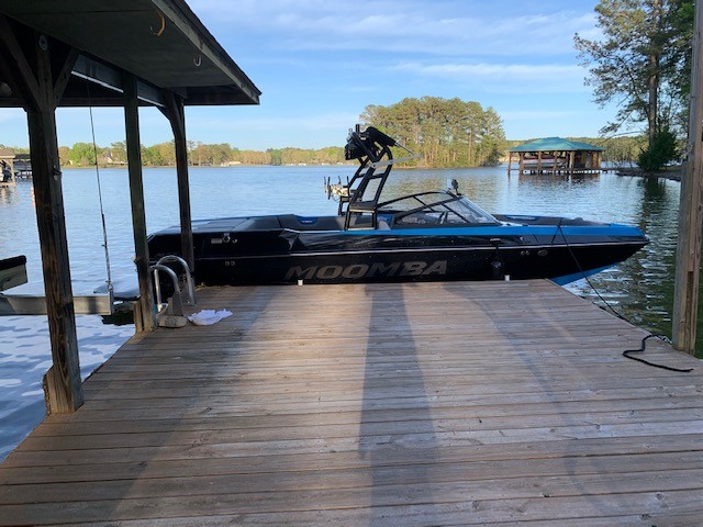

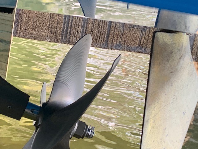

    Hello,
    Recently purchased a 2018 max, great boat.
    Did not notice there was a small ding on the prop when I purchased it, Dang!
    Currently it has a OJ wakepro 15x13, seams to be fine, I think it vibrates sometimes, haven't put too many hours on it yet, Otherwise seams fine.
    We are mostly going to be using for Surfing, but also wakeboarding and skiing for guests. We are still beginners on the surfing.
    We keep the boat on a lift and don't usually go far distances, but would like a decent cruise speed. Usually we will have 4-8 people on board, and 2 dogs
    I see the OJ-945 and 2419 recommended, and even the 1234? I think.
    Ding is not too bad, so I will either repair and keep as a spare, or get professionally fixed and keep as a spare.
    Any recommendations would be helpful,
    Thanks,

    I called Eric he recommended the 1922, 15 x 12.5, and if I buy it from them they offer a free prop repair.
    Thanks,
    Bruce
    Mar 2021
    South Georgia
    1,967
    That sounds like a good deal. I don't think your repair will be a hard one. That bend isn't terrible, and honestly you could probably get some of that out with a couple of crescent wrenches yourself and make any vibration you are feeling much less. But, if you're gonna get the new one, just go ahead and let them take care of it.
