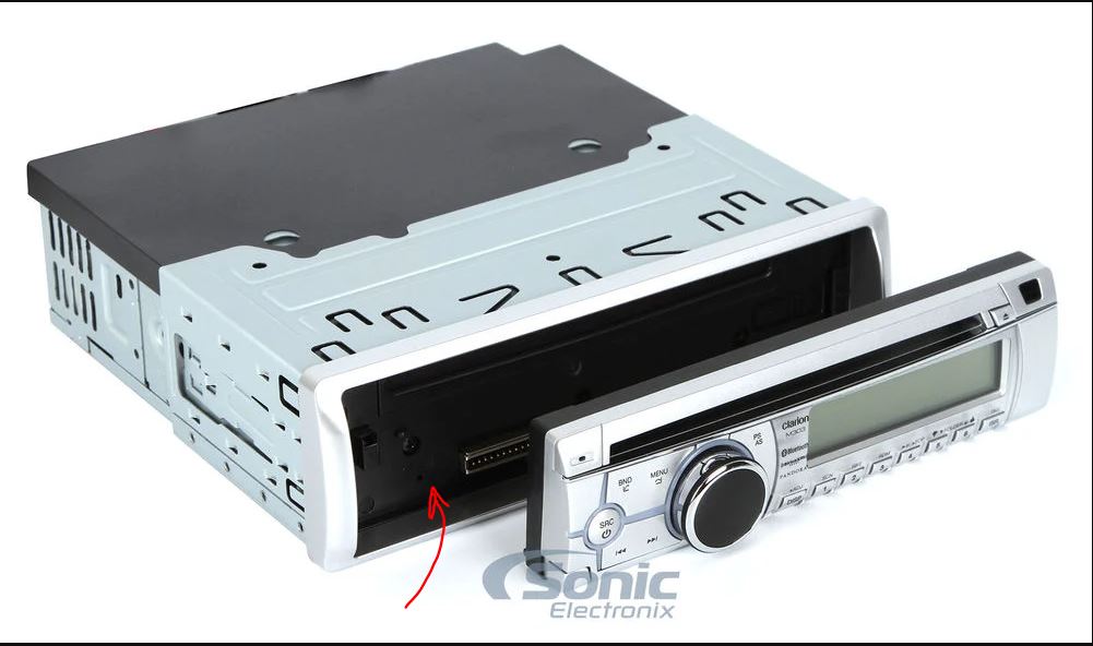

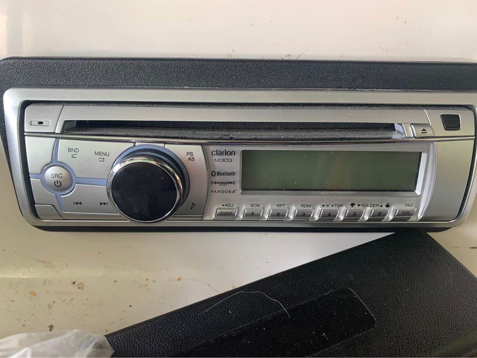

    Lastly, I have a radio deck in the boat. It supposedly has blue tooth & I've even looked it up in the owner's manual of the head unit to see if there's something I'm missing, but it really won't connect. There are no aux hookups & the lakes we go to are pretty remote so we only have access to one radio station & even that is pretty spotty. I noticed you can grab the head unit and just unplug it from what looks like a big circuit board behind it. Can I just replace the head unit with any of the same brand and just push the new unit into the existing circuit board or will I need to replace them both? Anything else to consider?

    What you are seeing is the face plate detaching from the head unit. Its concerning that you are seeing the PCB. If it has a detachable face plate, what should be left behind is a black piece with a row of male terminal tabs that contact the face plate when it pushed back on. So to answer your question, no, there is nothing that will do what you asked.
    On that M303, IIRC, you need to go in and purge all the old connected devices. I believe it can only store 3. Once the old paired devices are purged, you should be able to connect your new device.

    I guess I was wrong, sorry. As I mentioned the boat is in storage...this black plate in the picture is what I see, not a circuit board...whoops.
