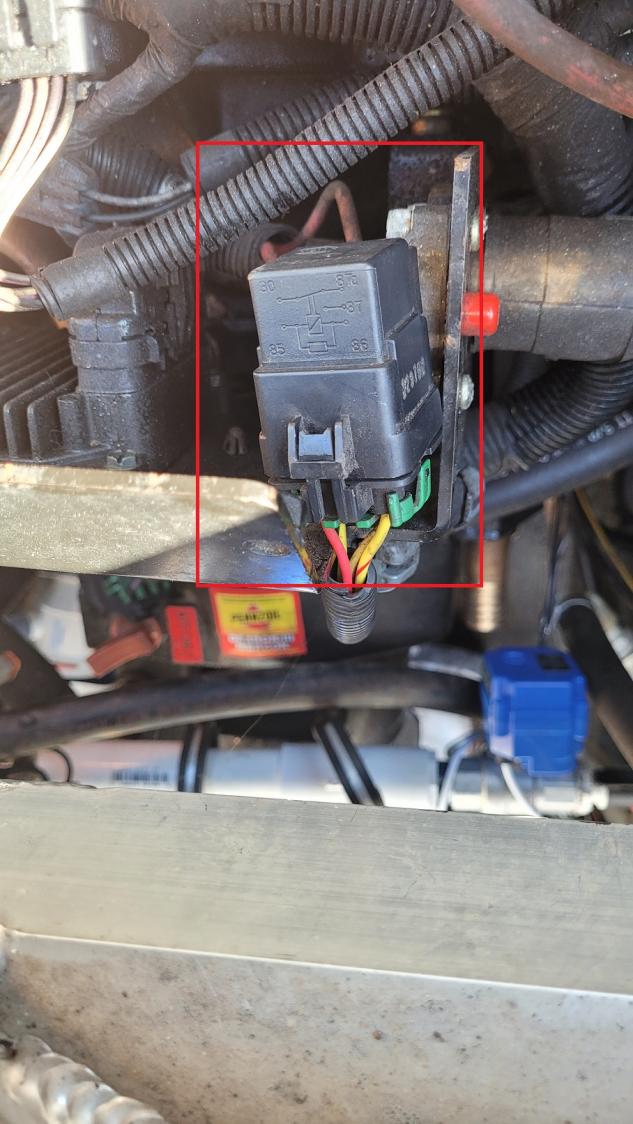

    Here is the piece that is clicking, any ideas what it is?20211016_131114.jpg
    ~2003 Moomba Mobius LSV
    May 2018
    4,935
    Looks like a starter relay, sometimes they include a fuel pump relay if the boat has EFI

    Looks very similar to the starter relay on my old truck.

    I replaced the relay and the new one still does a SINGLE CLICK when trying to start the boat.
