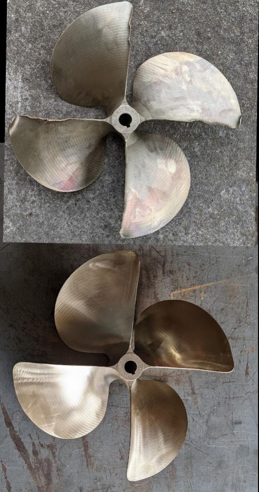

    We finally dinged up a prop this weekend on a log. What is the quickest turn around shop to get this fixed? I’m paranoid now not having a spare.
    Aug 2020
    Middle Tennessee
    736
    I just had mine done at https://www.propshoptn.com/
    225 shipped back to me for a badly damaged 16" prop.
    They took about 2-3 days.
    Highly recommended, nice guys and good on communication.

    Also go ahead and buy a spare, sucks to lose a whole week if you ding one.

    Depending how damaged it is and how quickly you need it repaired- I bent over the ends of two of the fins on my prop a week ago and temporarily fixed it myself (for now as I didn’t have a spare). Can’t miss any boat days!
    I made a template from a good fin and using a large adjustable wrench I careful bent the fins back until they matched up with the template. Took it out this weekend and it worked perfect...no vibrations.
    I did order a new prop and will get the damaged one professionally repaired/balanced.

    Aug 2020

    Looks new!!!!

    Looks new!!!!
    Hope it runs like new!
    I still can't figure out what happened here, I was in forward when this happened.
