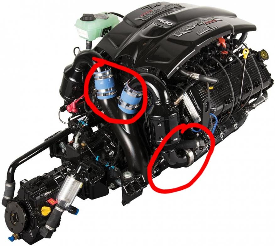

    I hate to ask the obvious, but can you specifically point out to me what clamps...as I look at the engine there seem to be a lot! Sorry. My engine experience is limited!
    Check these connections.
    Back of the engine can access through rear lockers/v-drive doghouse. CATS are the canisters on the exhaust.
