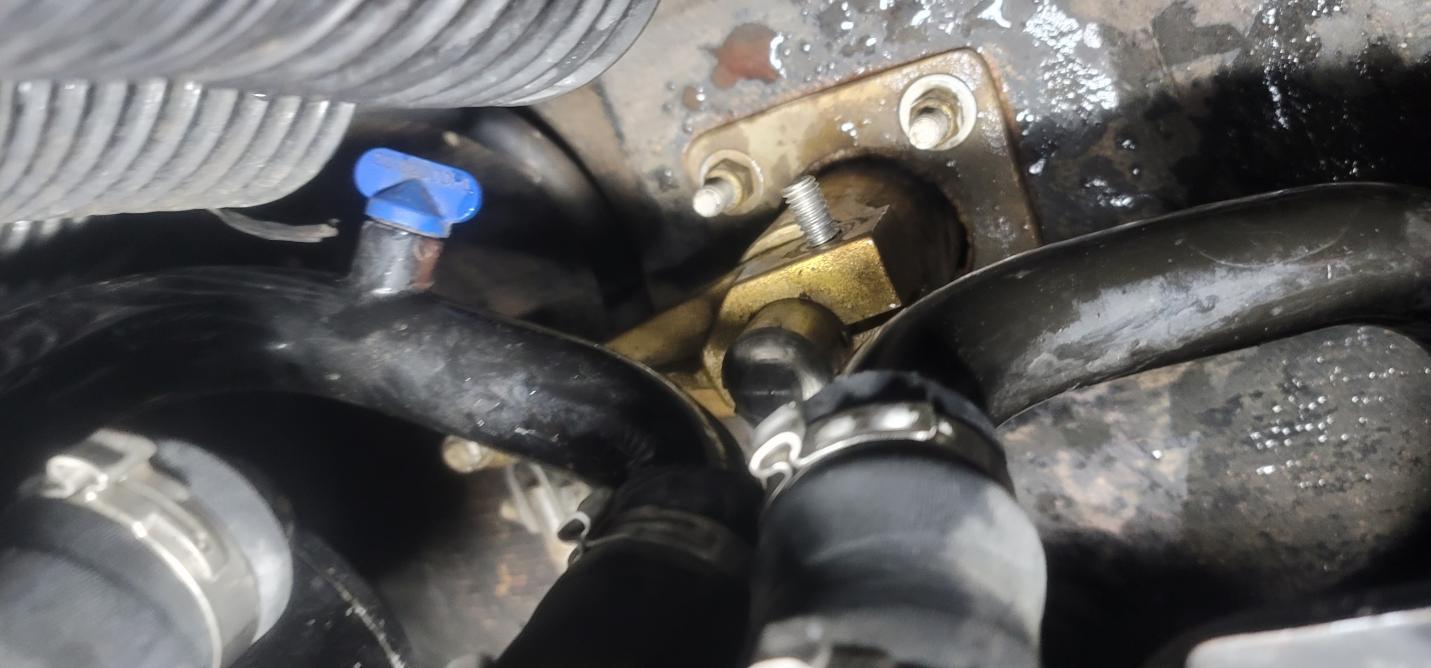

    Next, I was lucky enough last outing to get the boat on the trailer far enough forward to remove the rudder. You could let it hang 4" back to accomplish the same thing. I have seen jacking the hull to clear also, but I never had a problem.
    The hardest part is the SS cotter pin. There is no room to work and it does not want to be straight again. Once I donated blood to the mechanic gods it came right out.
    Once removed, te nut and bolt for the tiller arm is straight forward. They are stainless and non-magnetic, DO NOT DROP THEM.
    The tiller arm will release and the rudder will fall pretty easy once the boltnis removed. My dad came over to help and held the rudder and lowered slowly while I made surebthe tiller arm and key stock didn't fall under the engine. Once secured, he turned the rudder and pulled right out.

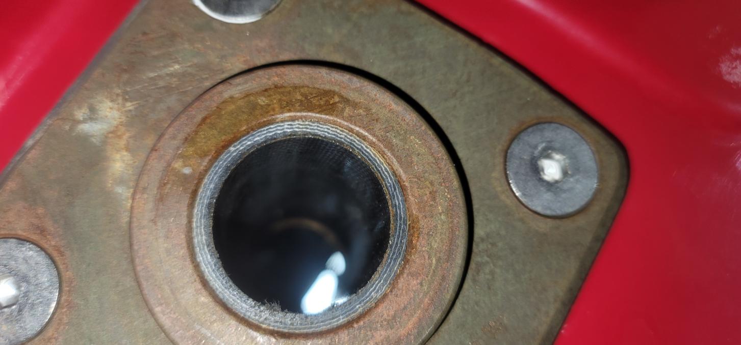

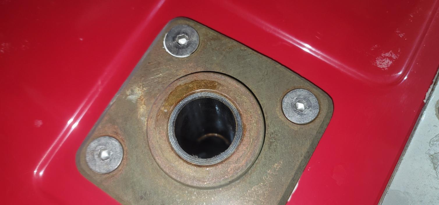

    Port box only has 1 O-Ring at the top. The rest is sleeved with a carbon liner (yes $0.50 o-ring = sunk $80k boat), I was shocked also.

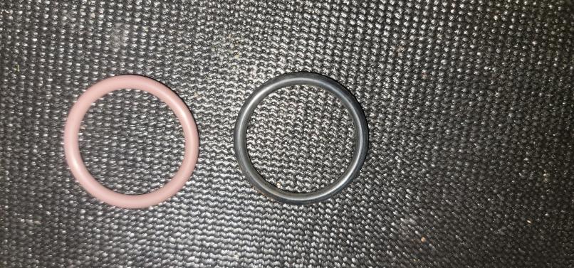

    Old o-ring (black) vs new
    I used marine silicon spray lube to work the o-ring in from topside. Really simple from there. Just feel around to make sure it seats in the machined groove on the inside of the port box. I then sprayed the rudder shaft and had my dad insert it slowly to not dare the new seal.

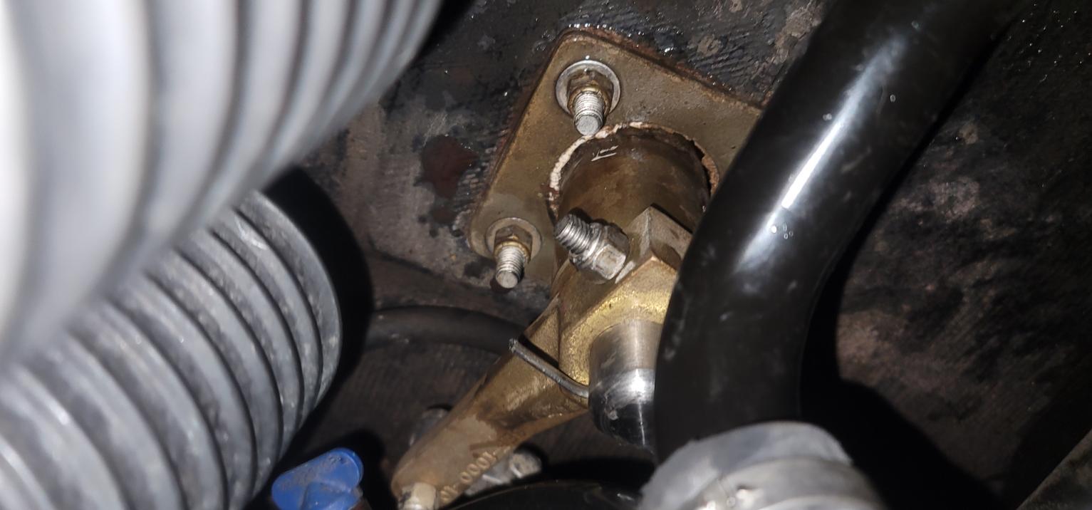

    * You have to install the tiller arm at the same time the rudder is being inserted.*
    It slide right on but I wanted to make sure everyone knew this is a 2 person job. They key stock is a little tricky to hold and maneuver with 1 hand but go slow. Once on amd key in position push down on the tiller and push up on the rudder at the same time until both bottom out. Then re-insert the 3/8" bolt (took some wiggling) and tighten everything up.
    I reused the cotter pin but that is up to you. Again, this was a pain to bend once I got it through the rudder shaft.
