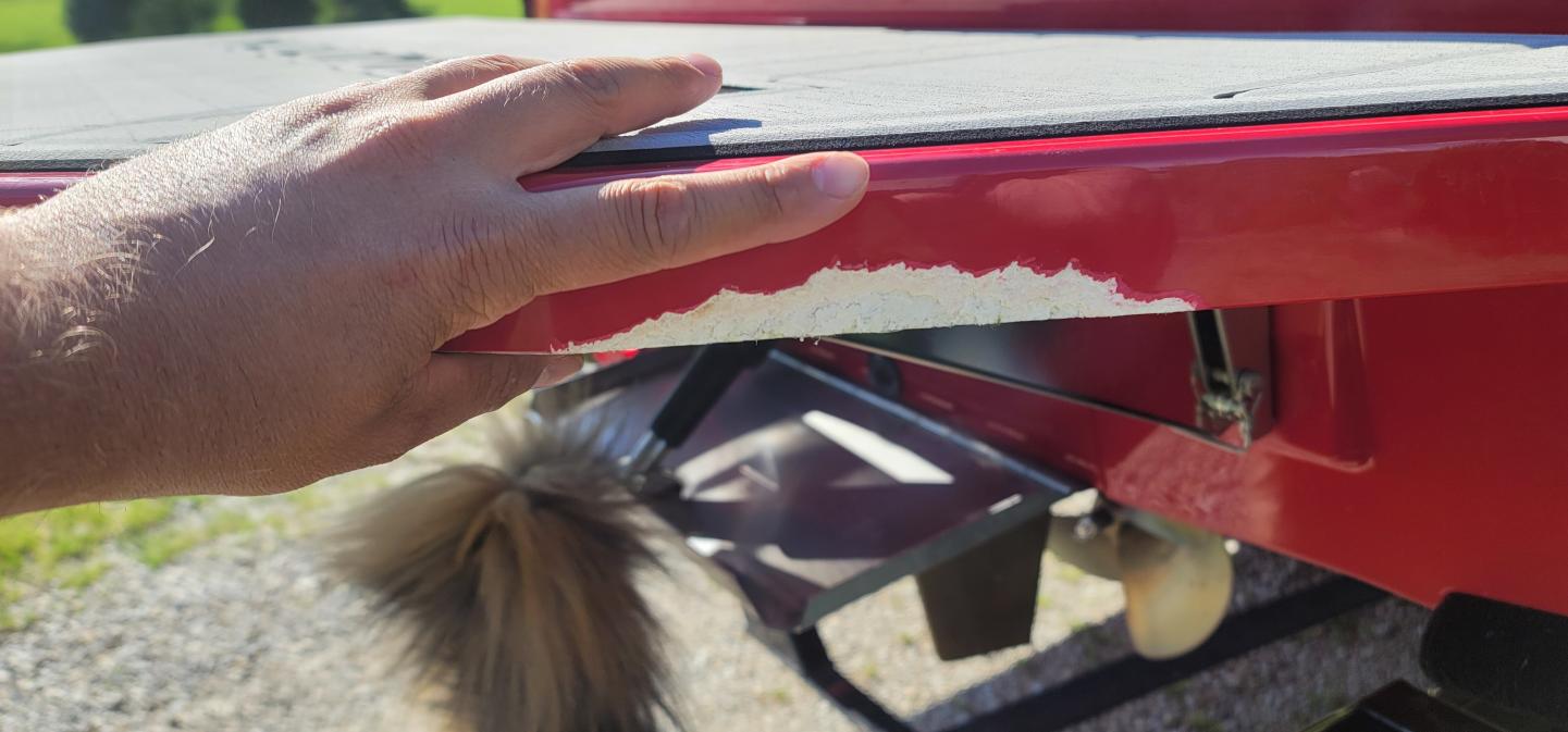

    Well it happened.....putting the boat in, wife tried to backup and of course we all know these boats don't turn, and the swim platform rubbed the dock. The metal framework dock. So now I either pay for some gelcoat repair or try myself. I stayed calm and supportive because she was already mad enough for both of us. It looks to be only gelcoat damage and the fiberglass just needs cleaned up.
    Biggest problem is it is faded red so color match will suck.
    Just looking for opinions, should I try it or not? What kit do you guys recommend? Would 2oz do it or do I need 4oz?
    About 6 inches long.

    I'd totally do that myself. I'd use the factory color and call it a day.
    Aug 2011
    2,522
    Yep and if it still bothers you have a professional redo it over the winter when they have less work.

    Well for a stipe that long, how much material do I need? I was thinking only 2 oz but the instruction say quarter size. This is definitely bigger than quarter size, but not deep at all. Just don't want to be 100% in and have 1/2 the material I need.
    Thanks for the support. I think I have a weekend projects coming up, between this and the rudder seals.

    I agree patch that yourself should take half an afternoon.
    I think a spectrum 2oz patch paste should cover it. Maybe get 2 just to be safe and if you don't use it you'll have it for next time. They are cheap and handy to have around anyway.

    Yeah...that is the one I just had the wife order. iBoats says in stock then when ordering say ships in 2 weeks. I hope it is faster than that. Would like to only waste 1 weekend fixing everything and not 2.

    took our spectrum order from iboats 3 weeks to get here. they were bought out by an investment house a few years ago and shipping has not been quick since.
    hope your luck is better.
