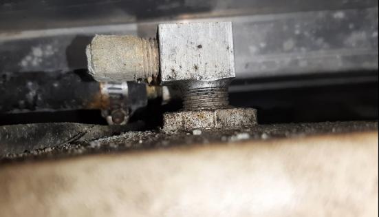

    My boat died on the lake last week . It wasn’t getting fuel so I replaced the fuel pump still didn’t work . So I traced the fuel line to the tank and found that the hose had broken at the fitting and was laying loose under the floor .
    How hard is it to get into the fuel tank ? Is the floor hard to remove ?

    Here is a picture
    5,457
    V-drive or D-Drive? Most floors are not that difficult to remove. Screws will be hidden in the carpet and/or around the edges. Then it's some careful prying and lifting to get out.
    My 2001 has two removable panels to get to the tank - one screw in each corner. Your results may vary.
