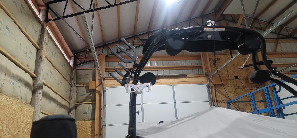

    Been searching all weekend for something that I don't know if it exist.
    I built a wider cross-member for 1 of my board racks to hold skis. It turned out great and it now 29" long to support outside of the bindings.
    I already ordered new tines for the swivel rack that I pillaged so I can hold a kneeboard.
    However, once I mounted my new wider rack to the upper mount of my S-bend tower I noticed it was not level. It is about a 15 deg difference front down. I used the same mounting pattern from my other rack. I checked the Roswell site thinking I screwed up and they have the same thing. What am I missing? Do they make something to allow the rack to rotate? I don't want the skis to fall out not being level in the rack. I could also get a large surf board up there when not skiing but then again they will be sloped forward 15 deg.
    Any ideas? Anyone seen this?
    I can post pictures after work, I know it would help.

    After looking at it, the holes are actually drilled and tapped that way from the factory on both sides. I never saw anything on Roswell's site except these adapters for the Triton rack.
    https://www.roswellmarine.com/produc...-rack-adapter/
    Not sure if this would fix the tilting I am seeing. I even looked at several other brands with slotted mounting but those are all clocked 90 deg (square vs diamond on Moomba).
    I might just roll with it and see what happens. Maybe designed that way so while cruising and the bow is up they sit level...IDK.

    I thought it looked bad. With the surf board it looks fine. I guess I'm just being picky about skis.

    Doesn’t look bad at all! I have the same tower. Is a fixed mount the only option to add racks to the uppers?

    Quote Originally Posted by BigOrange View Post
    You could add the swivels and make them come inside, but the ski rack length would be a head knocker for sure.
    Might also need an extension or something to get it to miss the bar when rotating. I believe the normal width racks fit fine.
